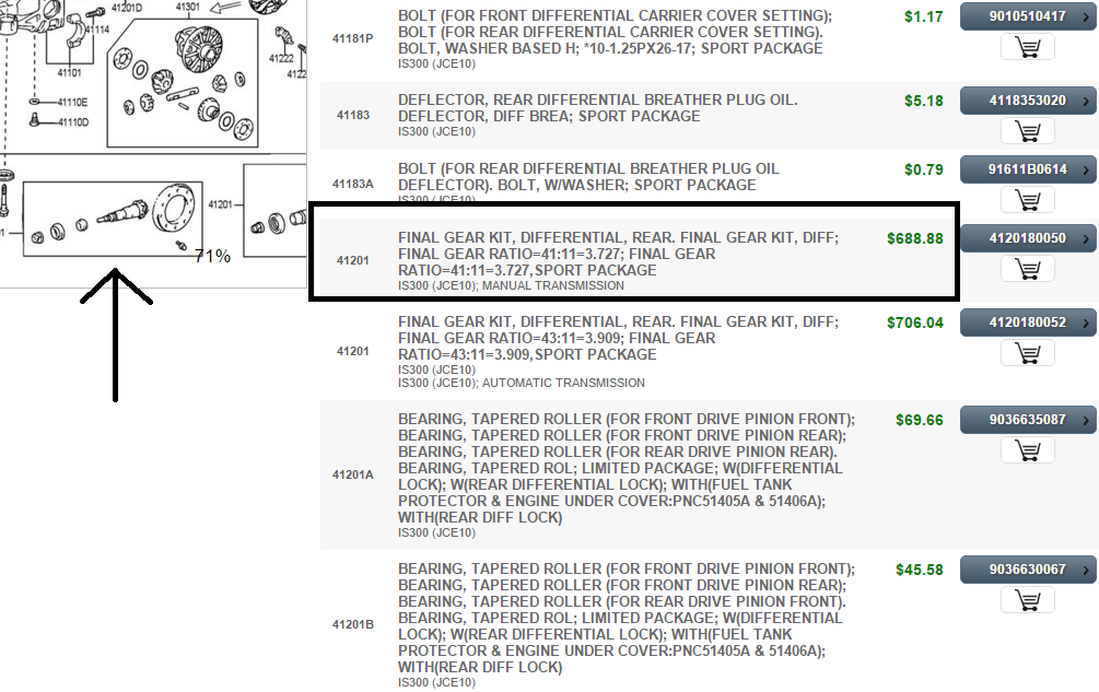

Yep good tires, tune and a 3.73 rear end would be great. I don't understand why no one makes a 3.73 kit and Im always looking for a m85 LSD at the salvage yards.
After going FI I feel the cars gears are way to fast now and I'm shifting more than anythiny. The 3.73 would give it longer gears and 2 gear should hit 60 without a problem. Currently, we gotta jump into 3rd to hit 60 and that kills our 0-60 time. Ya sure the rearend that ships with the car is good for stock but FI it's alot of work...

Old 11-14-2015, 11:02 AM   #21
spitfire481

Buy the m85 or the parts from Toyota/Lexus. It's the same parts as the other Frs final drive "kits".

Old 11-14-2015, 01:54 PM   #22
GsxrMe
GsxrMe's Avatar
Join Date: Jul 2015
Drives: Late 2014 Subaru BRZ
Location: Cape Coral, FL
Posts: 557
Thanks: 20
Thanked 184 Times in 139 Posts
Is there a m85 rebuild kit I can buy to just convert my housing? I would love a url link.
You have to get the parts from Toyota, plus the shims to get the lash correct

Is this the correct parts list for the M85 internal swap? It looks like its the same price to buy if used and beaten from ebay as it is to buy the parts new from the dealer. The image is below. I rebuilt a rear end for a friends 1990 Monte Carlo; so same concept I would think. Take you time, measure 50 times and a 6 pack of beer.
No wonder the damn M85 is hard to find. The tech is from 2005! Thank you Toyota and your old ass tech in my 2014 BRZ!
