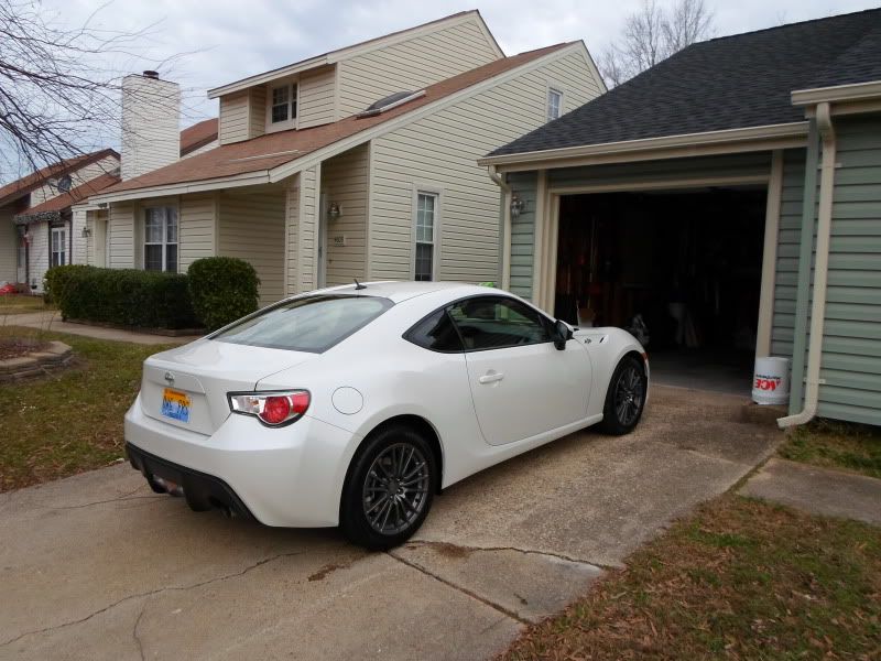

yeah that's what worries me about running a wider tire on a +53 wheel. Differences between brands have the possibility of not fitting. As I mentioned, right now on the 11 wrx wheels the 235 fits with a quarter inch of clearance.. but if I went from the kuhmo to say.. Nitto (that run a little wider) .. It would likely rub.
Not something I want to find out the day mounting and balancing new rubber happens. 225 is plenty fine for my uses. If I need to go wider for any reason I can always sell and go for different wheels.
Thanks for the pic! I see that they rest in just about the same spot that the 11 wrx wheels do. I've been trying to visualize the gold against whiteout but no pics on the net of that exact combo on a FRS or BRZ.
In case anyone was curious, here's a couple pics with the 11 wrx wheels.
