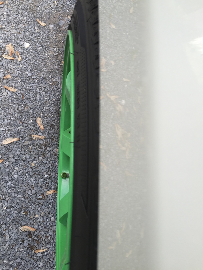

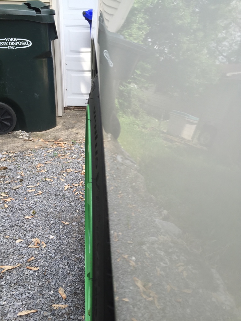

Size:  243.9 KBName:  ImageUploadedByTapatalk1432703200.657346.jpg
255 on 9.5, the edge of the wheel is exposed from the side, and the sidewall is not 90degree angle, thats what i call a slight stretch

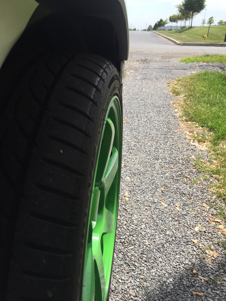

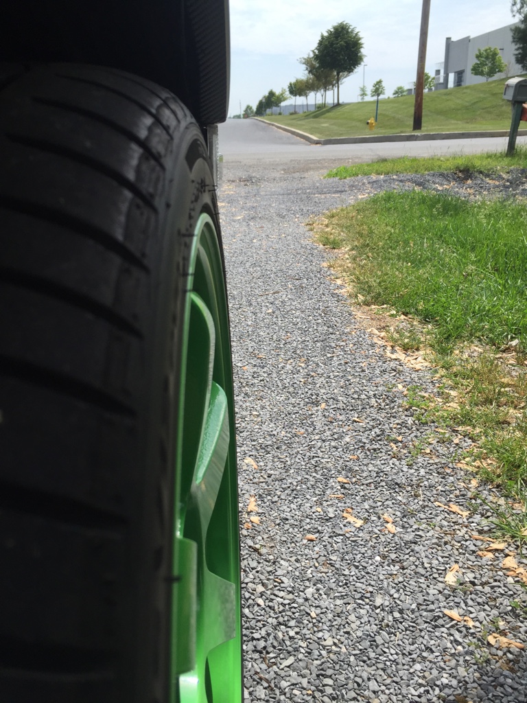

Size:  320.6 KBName:  ImageUploadedByTapatalk1432703226.234547.jpg
255 on 8.5, perfect fit imho
jshadeck is offline   Reply With Quote

Originally Posted by jshadeck View Post
Attachment 110651Attachment 110652
Attachment 110653Attachment 110654
Yeah that does look good, the front is perfect
