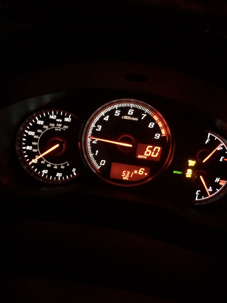

Off topic, speed with the 4.88 final drive
