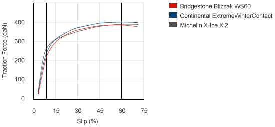

Your highest level of traction, measured by acceleration force, is with your wheels spinning quite a bit. Most of us are trained to think that wheelspin is bad but with snow tires on snow you get the best traction with significant wheelspin. Take a look at some of TireRack's testing:
This is exactly why you turn off traction control when driving in snow, you need the ability to have wheelspin at times.

Wheel spin helps to get moving. You don't have 40% wheelspin when you are cruising in snow unless you are ken block
Id leave it on or sport unless starting from a snow mound or going up a slow steep incline. But i drive an accord in snow it doesn't have traction control or vsc

This is EXACTLY the reason why a single press of the TCS OFF button turns it off just up until 31mph(50kph). It's to help the car start off in snow, and then automatically turn back on once the car is moving.

If you were cruising (35mph) on a highway with snow/slush on the ground, wouldn't it be easier to recover if the car begins to slide out with traction off?

Kinda, but ultimately, no.
While having the computer fighting your inputs does make advance slide control techniques nigh impossible, it can still react much faster than any human can. Additionally, it has greater control over some aspects of the car than you do (individual brake control for one). The big problem is that in the situation where a car that's going along perfectly straight and fine suddenly begins to rotate, the car is often beyond simple driver intervention. Compounding this is the fact that it's never when the driver expects it to happen. Even a F1 driver can be caught out.
The best option is a combination of skilled driving and computer assist. A skilled driver will be aware of road conditions and can use techniques to minimize the possibility of a sudden and surprising loss of control. In the event that traction suddenly drops away, the computer can jump in fast to nudge the car back on-line before things get beyond the point of no return.
