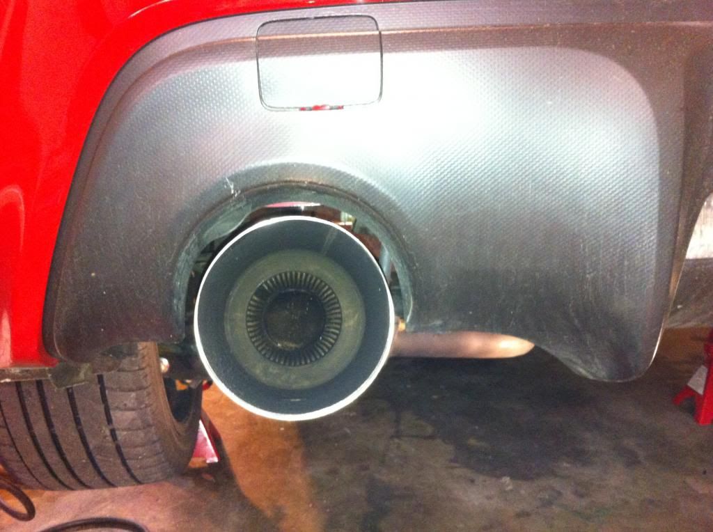

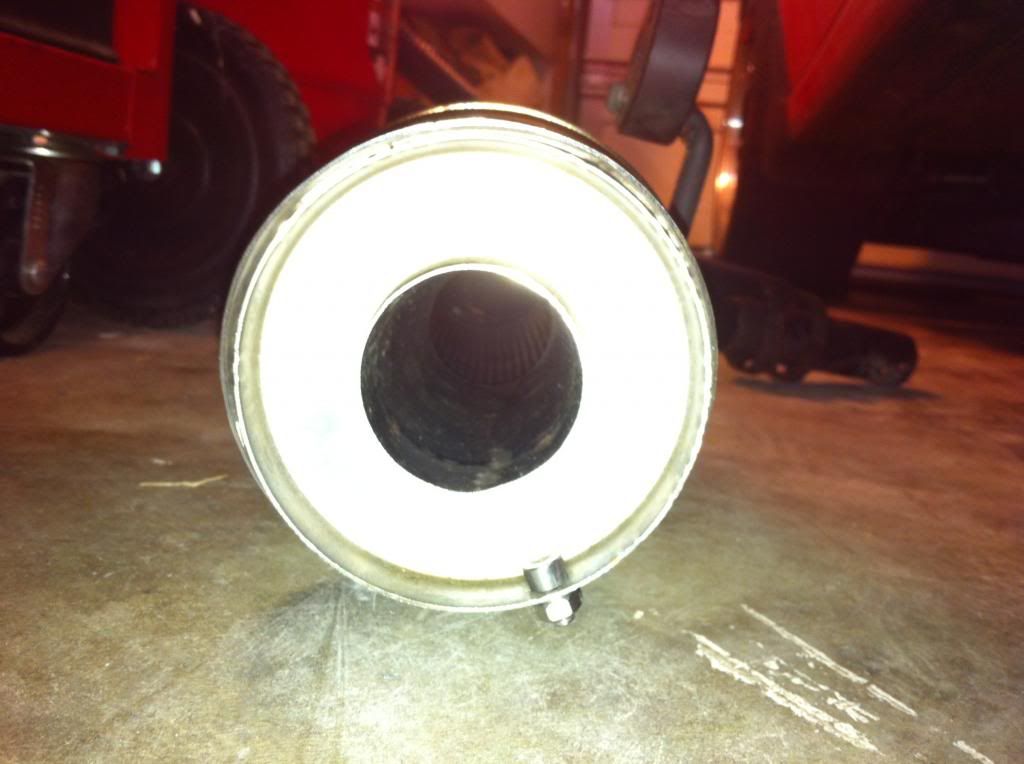

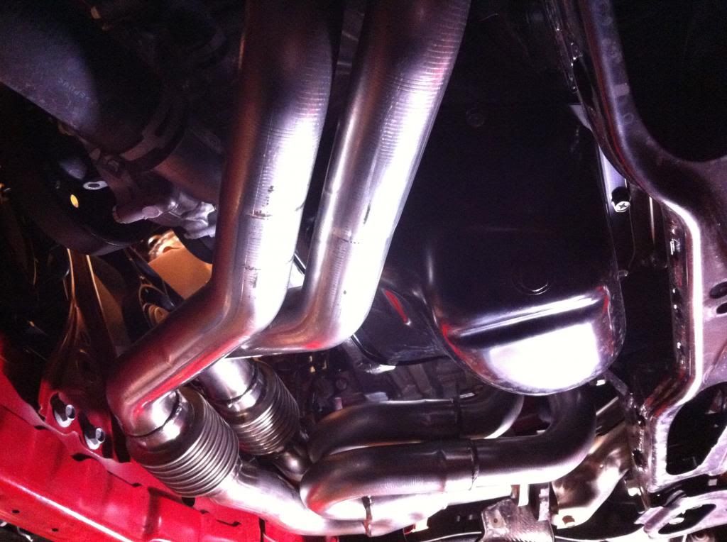

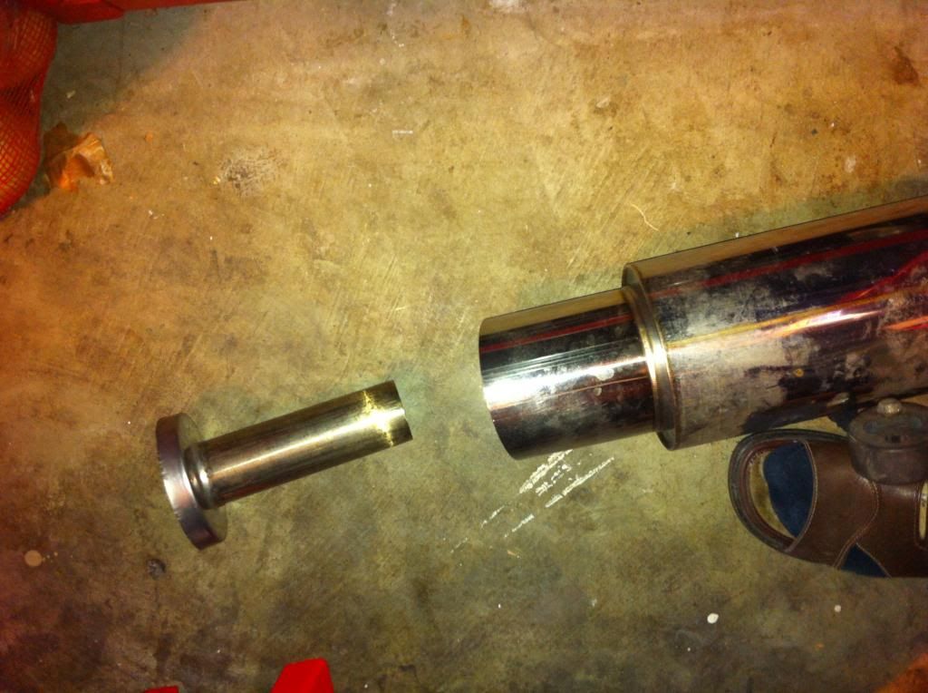

So, here are some pictures and videos of everything exhaust related
1: Borla UEL Header upfront
2: Factory Midpipe, which has has the rear mounting plate cut off and moved back about 1 foot.
3: (CENTER) Apexi N1 Muffler, 3” Inlet, 4” Outlet. 3”
(LEFT) Car Chemistry 2-Plate Exhaust Insert
(TOP) Silencer
4: Car Chemistry Insert, Closeup
5: Car Chemistry Insert, Installed. That is the factory exhaust mounting plate. Which has been bored out to 3". It does not leak
6: Silencer, Closeup
7: Silencer, Installed
8: Ready to install, (w/o Silencer)
9. Muffler, Mounted
10. Muffler, Rear View
Videos coming up in a few minutes

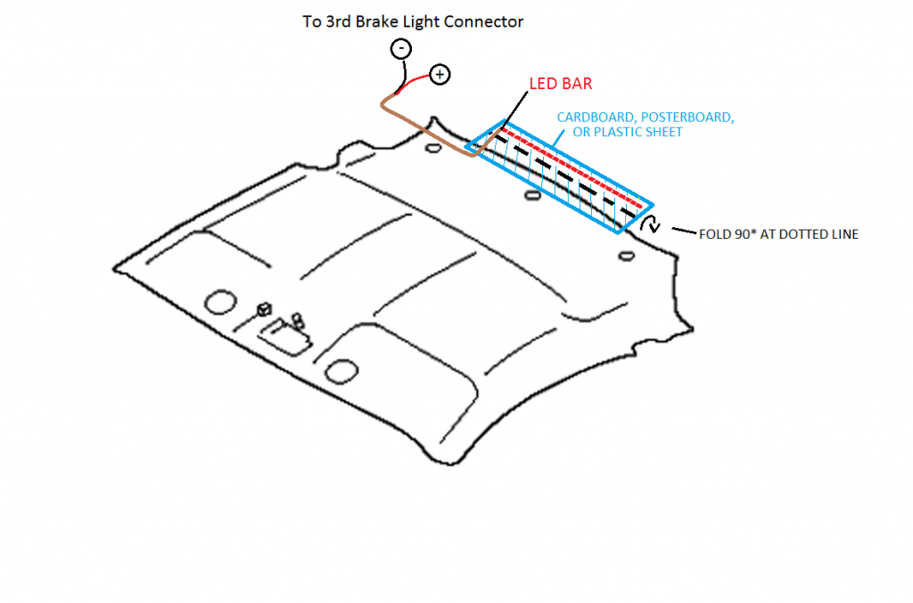

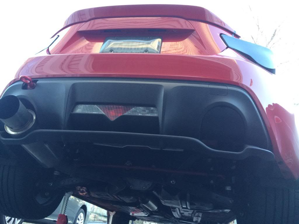

So, I did the following in under an hour. Do it all at your own risk I did not have to disconnect my battery.
1. Purchase SMD LED Light Bar w/ Red Diodes.
Mine happened to be 2 12" pieces with 9 SMD LED's each. Let me reiterate: You do not want to purchase cheap/faint LED's and get rear ended by someone because they didn't know you were braking.
2. Unclip 3 retainers towards the rear of the Headliner.
Let the headliner sag/drop down a bit.
3. Remove Rear-Right Passenger Airbag Cover.
You will be snaking your wires, which will require this panel to be removed. Go in the trunk, towards the bottom of the deck shelf: on the right side you will see some exposed sheetmetal and a 3/4" hole. Grab a wire hanger, and slide it through that hole, you will see the other hand conveniently sticking out from behind the Airbag Cover. This is your route.
4. Fasten LED BAR to your board of choice.
The board has to be thick such as cardboard. Fold the board so there are 2 sections: one for the bar, and a bigger section that will slide over the headliner. When the headliner pops back in place, it will hold your DIY contraption quite sturdily. But... DO NOT FASTEN THE HEADLINER JUST YET! Temporarily hold the LED bar in place, where you want it, using tape.
[b]5. Enclose new LED Bar in a SHROUD.[b]
I used the factory shroud, cut in half, and currently being fiberglassed to size . At the moment, there is tape around the LED Bar to prevent ambient red light from flowing into the cabin.
6. Solder factory plug off of OEM 3rd Brake Light to new LED Bar.
Straight forward.
7. Snake new end using existing route
ie, TAPE IT TO THE HANGER AND PULL FROM THE TRUNK! Then pop Airbag Cover back in place. Pop headliner in place.
8. Plug in and drive safe.
I will post pictures of mine in a few. Hopefully, you can get a headstart now
hamzam is offline   Reply With Quote

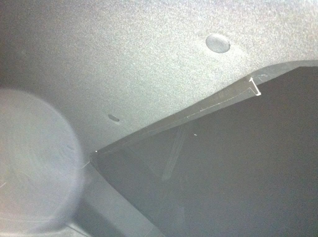

Here's mine without any type of shroud, just as you would install it.

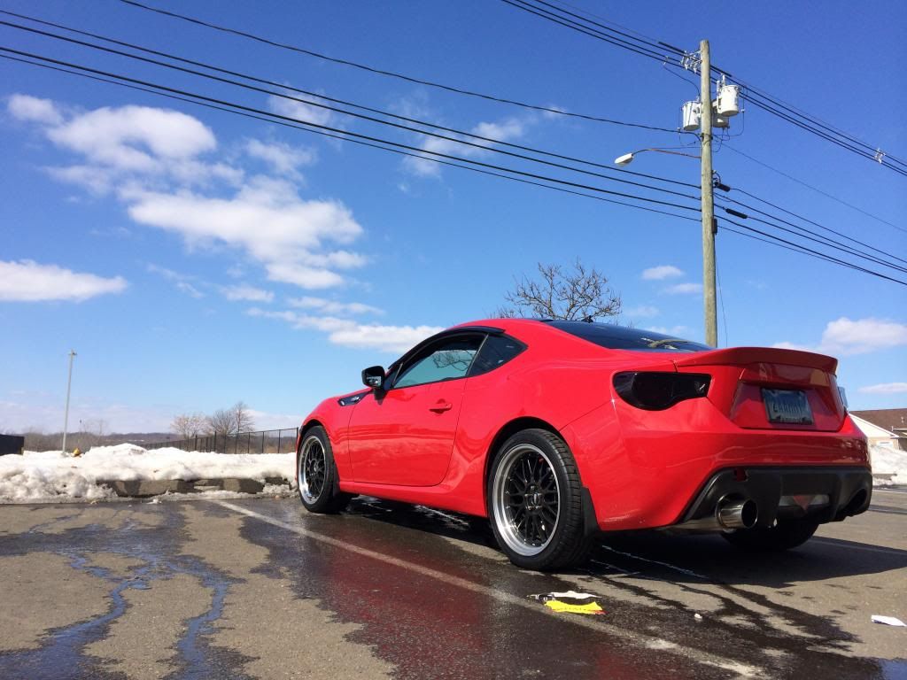

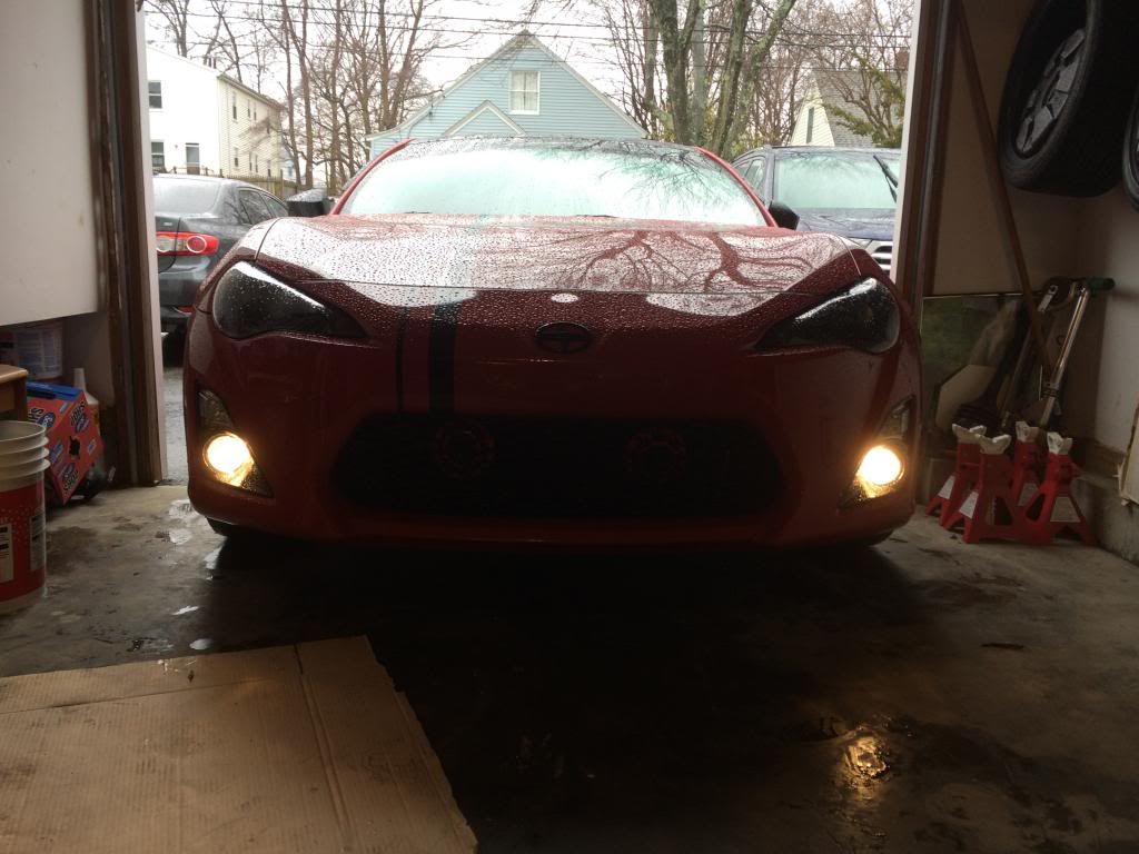

It's been a while since I last updated my build... but work has not stopped on the car! Time to unleash the beast :P
I always seem to be doing something or another so I updated the mods list as well... Not everything is covered in this post :X
So...

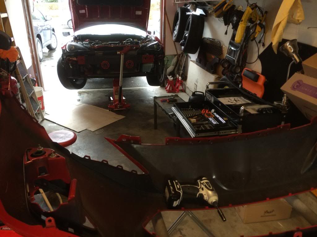

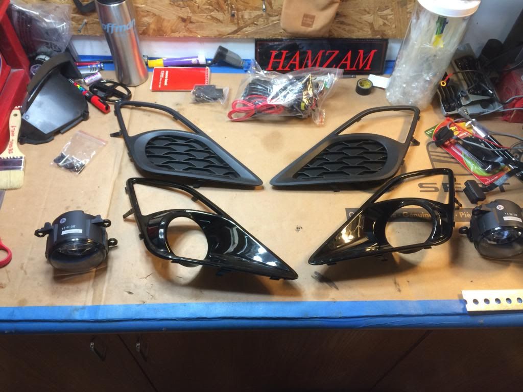

Left off with the horns minus the grill.
For good reason! There was a lot of "sawwing" to be done. It took forever. But I was patient. So was my condenser.
In the meantime, over a rough winter, met up with Sklimo, very cool dude, his car is LOUD. It still echoes in my head.
...but his car made it very apparent that I needed a drop. No matter how rough a winter.
One must "Seize the day"...

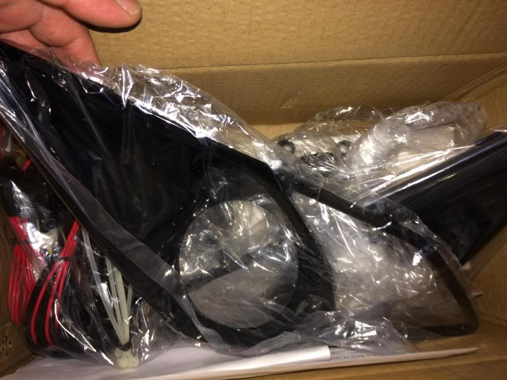

"So..."
"Oh, why not, throw in some fogs, you gotta take that bumper off for the grill anyway."
"You've been eyeing it for months! It's less than $20!"
Oh, how many times I've done this, I've lost count!
Alright, here we go....
Done!
Fogs work beautifully, and are surprisingly bright! Great for that blond spot at night right in front of you.
Yummy... Been driving around without a grill for like 2 months! Finally.

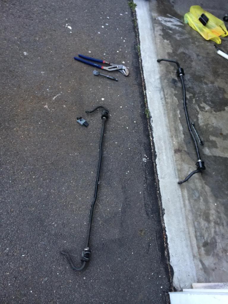

Ok. Let me just say... Incredible. First car I've done sway bars on. Haven't even put the springs on yet. The amount of increased grip. Wow. More understeer, but I can turn-in harder and faster. Car is FLAT.
Pic of rear sway... and DAT ASS! My tow-hook-cover came flying off somewhere.. So I had to improvise. Also, Rear-Diffuser installed as well as FT86SpeedFactory Exhaust Cover. It was metal. I was surprised, thought it'd be plastic!
I want to put a glass plate here just to see the shift action! Kartboy SS pics not taken, sorry! It's evident with reverse lockout, however.
....and $6 for a new tow cover. That is where I stand today.
Springs and Camber-Bolts... next weekend!

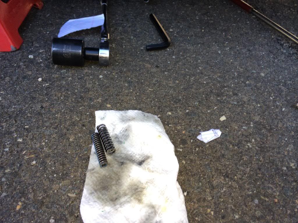

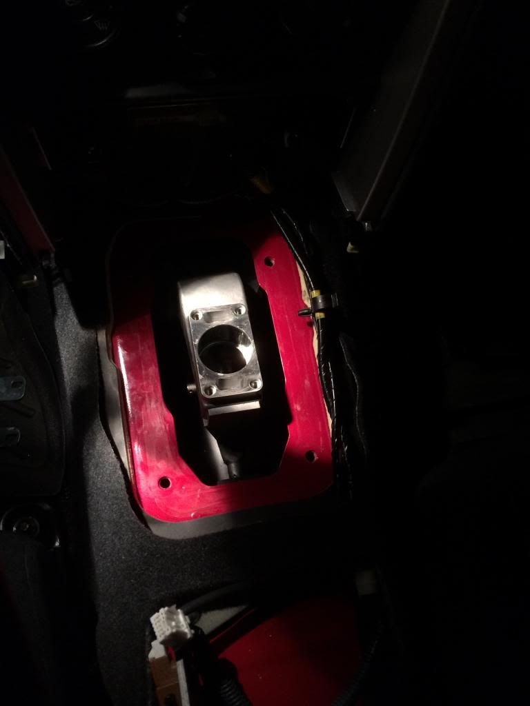

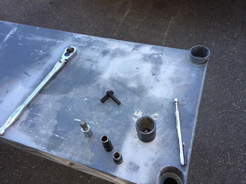

Got up early this morning
Time to finish up the shifting feel.. MTEC Shift Springs and tools.
..all done! Very tight area to work. Now, with this (on top of Perrin rear shifter bushing, trans fluid swap, kartboy short shifter and white line positive shift kit, my choice MTEC drift shift knob) the gearbox feels like it is gated. Super precise gear selection once the springs went in...
I am very impressed by the firm, crisp movement of the shifter
I can cut through 6 gears (clutch disengaged) in 1 second, and I barely have to guide it. Wow... No way to shift into a "wrong" gear.

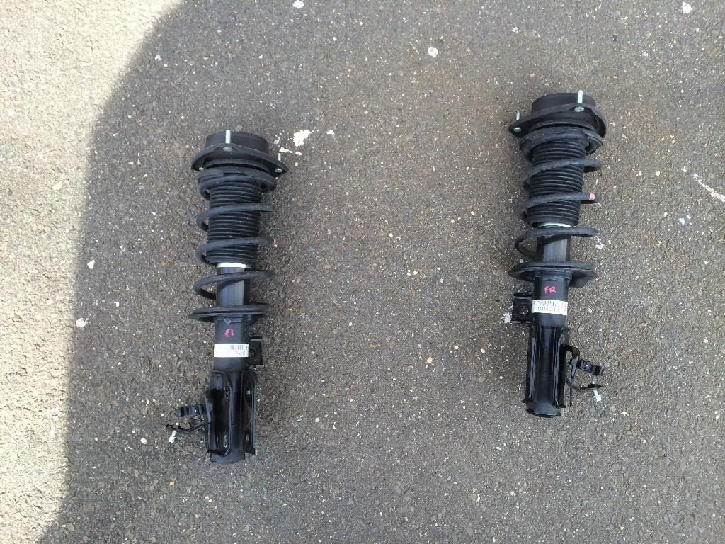

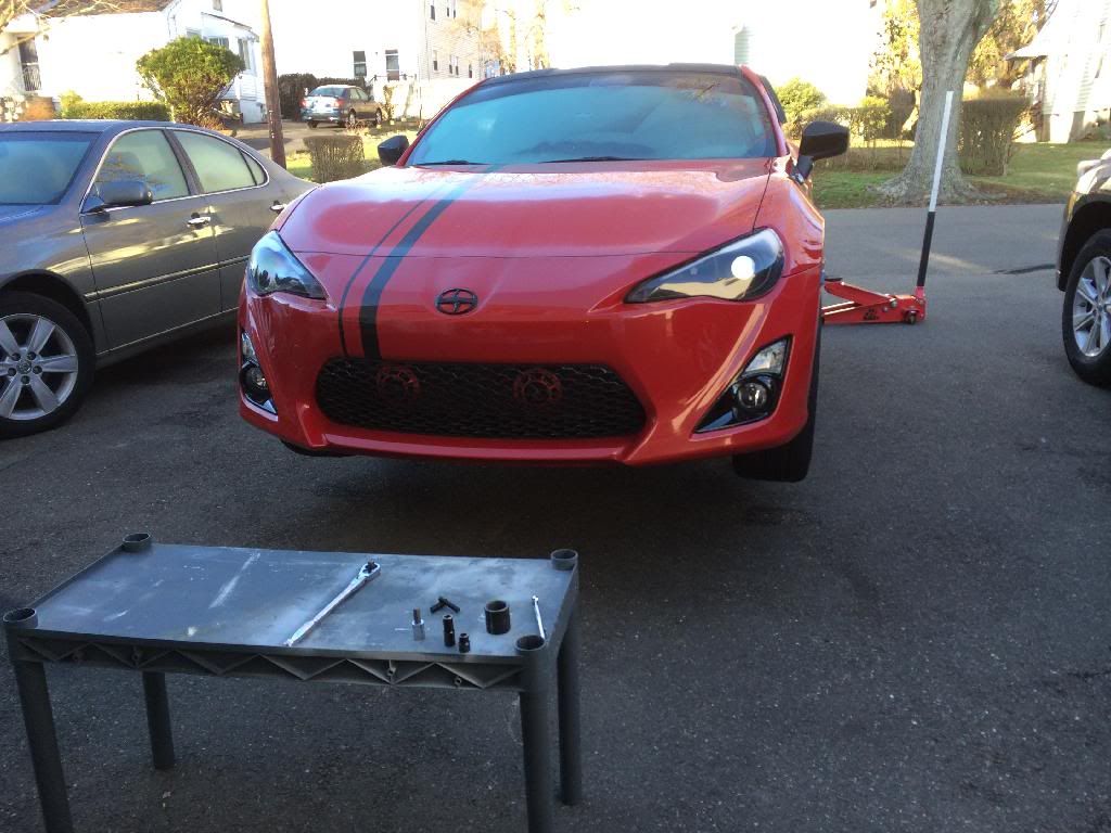

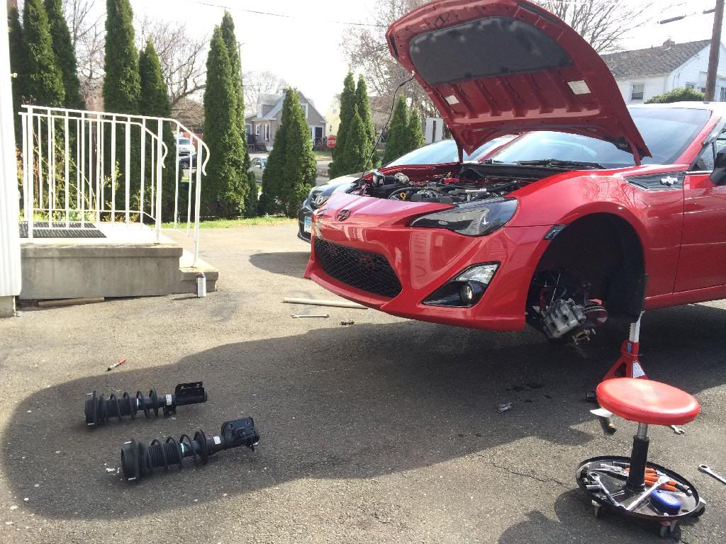

Went out and bought a spring compressor. $14.00 later...
Front Shock/Strut Removed
close up... Thought I had pics of rear! But guess not :p
Mounted Eibach Pro-Kit springs on afterwards ... All this being done yesterday afternoon. First time doing springs, easier than I thought!
