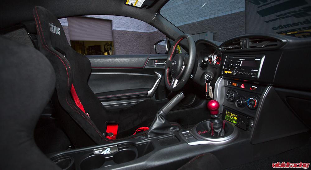

No the best picture but we got Status Ring GT's in our FRS
