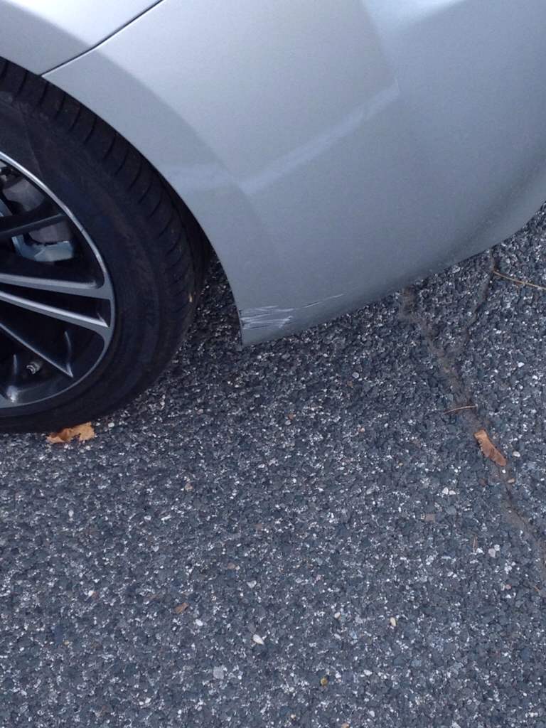

Here's the scratch from farther away

if you feel scratch by your finger nail, you can't fix it with any super duper "Scratch X" type of liquid/paste wax. touch up will make it better but you will see difference between original paint and touch up.
to fix that, you need to paint whole bumper again.
I would get rear spat that covers that area or ignore until get it repainted.

Any quality shop could easily feather it out and blend WITHIN the panel. So you would only have additional clear on the top edge of the bumper. The scratches are far enough down to where they wouldn't need to blend into the quarter panel at all. If they do suggest it, in this case I'd say they are trying to get more work/money.
If your going to fill the scratches in you will not get a perfect match. The way the flakes in the silver paint will lay (and reflect) differently causing the repair to be noticeable. 2ft back any you won't notice. It's on plastic so you don't have to worry about rust so the quick repair maybe the way to go if it doesn't bother you.
STI styled spats do look like they would cover it though :P Bayson R (ebay) just released their knockoff for under a third of the original STI part cost.
Originally Posted by boxer 2.5 View Post
Sigh. Body panel filler, sand it. Body panel filler, sand it. Primer, sand it. Self etching primer. Base coat paint. Second coat of paint. Third coat of paint, sand it. Base clear coat paint. Second clear coat paint, wet sand it. Third clear coat paint, wet sand it. Buff it. Wax it.
Silver blends easily compared to many other colors. Just go paint color-match sites and order a spray can. This total process should take about 6-7 hours with drying time.
Self-etching primer is to only be applied to bare metal surfaces.

After seeing the scratch, definitely start with rubbing compound, it's probably only 1/4 as bas it looks, all the white will probably rub out, leaving just the small black lines which you can touch-up.

Like others have said:
[ame="http://www.amazon.com/Meguiars-G10307-Scratch-X-2-0/dp/B0002UNON8"]http://www.amazon.com/Meguiars-G10307-Scratch-X-2-0/dp/B0002UNON8[/ame]
Clean and dry the area, then use something like that on it, then a little water and dry it with a soft cloth. Use touch-up paint, but don't overfill the scratches and let that dry for a day or so. After that, rebuff with Scratch-X, finish filling scratches with touch-up paint, let dry for another day and then buff it out again with the Scratch-X.
That should get it looking pretty good. I've always had pretty good success with touch-up paint and a good quality rubbing compound.

I think I'm going to go with getting the spats, I really like the way they look.
