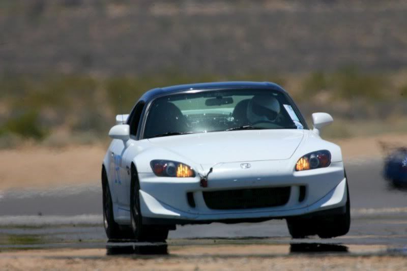

I actually generally drive over every berm and bump; this is where good suspension comes in.
However, if I don't do the pedal dance, VSC/TC will kick in virtually every time there's even a HINT of wheel lift. Additionally, I can't trail brake without the pedal dance.
Autocrossers generally brake deep, rotate, and power out, due to the nature of their setups (they favor quick small direction changes and fast response, over static cornering grip; this is MASSIVELY beneficial in slaloms, but at the cost of heavily pushing in sweepers). This makes it so they don't run into the trail braking problem that I have.
I can't count the number of pictures of my car (and most cars I drive) on two wheels.
These pictures are at different corners.
CSG David:
Me:
Heh. (Nice photos.)
You're on the power, though, right? You're not braking heavily at that point. Don't some of the autox guys suffer from increased "ice mode" incidents with the pedal dance? They're still braking when they raise up and lock one wheel, which the ABS dislikes intensely it appears. "Do that, will you? I'm taking away your brakes, then!"

There are a few rare instances where I'll lift a rear wheel while braking, but I've yet to experience "ice mode".
As always, YMMV, but my on-track experience is duplicated by quite a few guys in SoCal.
