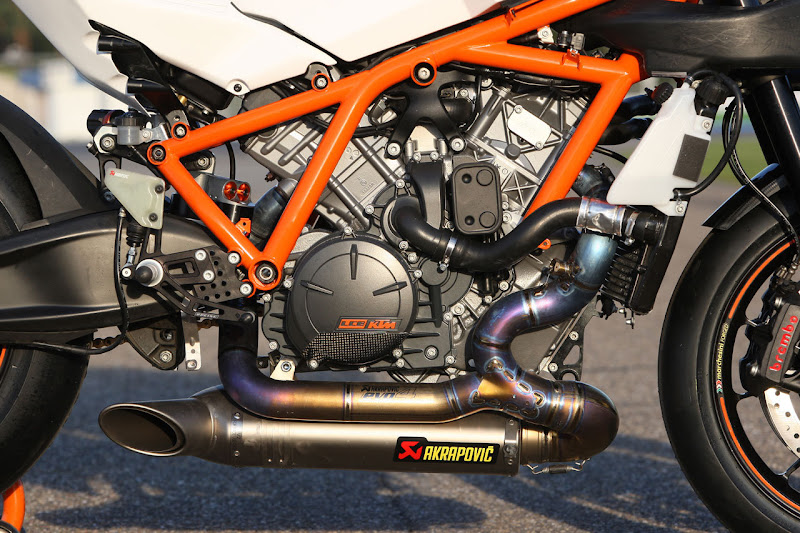

How much is an Akrapovic Ti bike exhaust?
(Arc is photoshopped in that pic, I hope.)
Because titanium.
There's a pretty convincing lens flare at the right hand edge of the pic, so I would bet dollars that it's real.
It looks like he's only tacking it, which shouldn't really cause much oxidation with sufficient shielding. From the way the one lower slip joint has some sort of rag stuffed in it, I'm guessing that the welder filled the tubing with argon once he tacked it. In any case, they know their shit. I got my hands on a full titanium Akrapovic slip-on for an R6 a year or two back, and it was an absolute work of art. Retail was something on the order of $6-700 iirc, but I got it direct from the factory in Slovenia so i couldn't say for sure.
Slip-on means just the muffler section? Like after the collector(s)?
Curious about the colour difference they're getting. Looking at the second pic that RRnold posted (911 rear exhaust section?), it looks like the bead is smooth (no 'stack of dimes') like we got on the little piece I made a video about a while ago. But they are getting a much nicer-looking heat band. More like stainless, than our 'rainbow'. EMS has a more colourful effect on their ti intercooler pipe, like ours. Different alloy, or less heat maybe?

Slip on means canister and an inlet pipe or for cars, rear axle back.
The 2nd pic was a EVO full titanium for a GTR which is about 6K. However, an EVO for the 370Z is SS piping and muffler so they seem to be mixing around their lingo for the cars.
Here is a full EVO full titanium for the RC8 which is about $2200.
Better shielding/backpurging is my bet. Rainbow colors on titanium are caused by the thickness of the surface oxide layer (Rayleigh Scattering rather than actual color change). Less heat would help, but I think in the case of the GTR exhaust, there was more to it than that.
