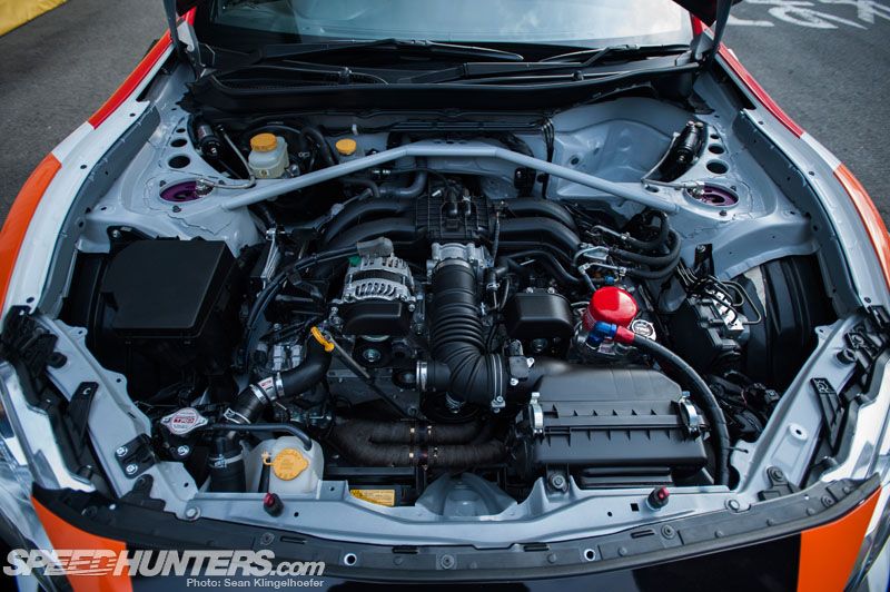

Look at the TRD griffon.
I'd say you're safe removing the resonator and sound pipe. They wouldn't have done it if it impacted power. All these parts probably were Yamaha's touch. The car does sound pretty decent stock (opinion) while remaining very quiet and unobtrusive at cruise.

Personally I like the Maxracing snorkel and plan to use one in conjunction with a perrin silicon intake tube. Only because I want to keep the engine bay mostly stock looking, or else i'd get the FA20Club intake.
1974 TA22 Celica
2013 86 GT
Last edited by Turdinator; 02-21-2013 at 12:07 AM. Reason: Link didn't work, added pic instead
