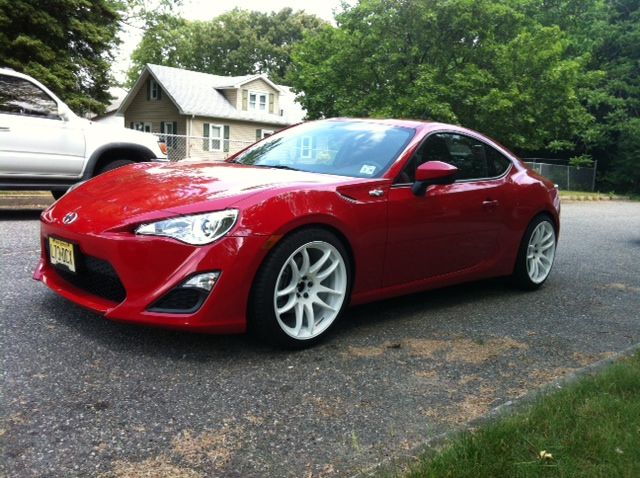

my set up is 255/35/18tires with work emotion cr kai KIWAMI 18x9.5 +38 offset.. Im lowered on H&R super sport lowering springs...Im also running a 3mm spacer in the front otherwise the wheels will rub on the struts... what can I do to push it back inside and not stick out(poke)... I know coilovers but I have no money for it right now... I also did my research wit camber bolts and camber plates. so which one is it gonna be the camber bolts or camber plates I should use? or both? if camber plates can they be use on stock struts/shocks? thanks

adding more negative camber will reduce poke
but im fairly sure when using camber bolts, inside clearance with the strut will be lessened and therefor cause the rub your already running a spacer to avoid
not sure if camber plates will also cause the same inside clearance issue aswell

Camber plates will help out. But camber bolts are a no go.

I don't know if any of the camber plates will work with stock diameter springs, but if they will then that's your best bet. I'm not sure if you'll get rid of all the poke, but you'll get rid of some for sure.
As said above the camber bolts will just end up putting the tire back into the strut.
As an aside, didn't you see the amount of poke coming from a 255 on a 9.5" +38 wheel up front?
