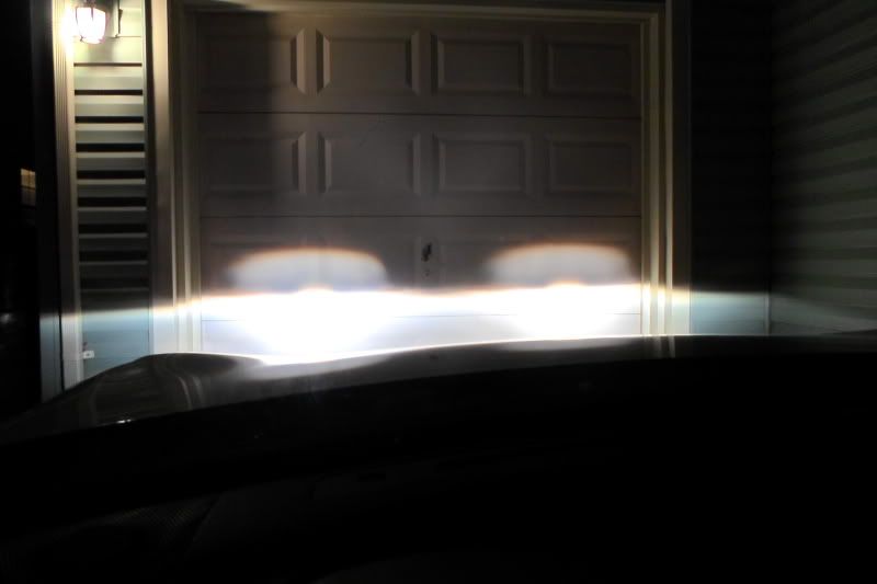

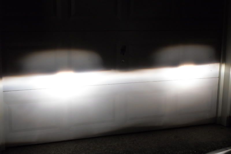

K so here are the pics. Driver side is H9.. passenger is factory H11.
You can see that the H9 is a little whiter and the pattern looks a little more full especially toward the middle and bottom of the hot spot. The cutoff is unchanged so no worry about blinding oncoming drivers.
Driving impression;
As mentioned, it was a little whiter and the pattern out to the sides and front is filled in better. There aren't any deep shadows like before in the foreground and the lights do seem to reach out better than before. Over all not a huge improvement but probably one that will show up better in bad weather where light output seems at its worst.
