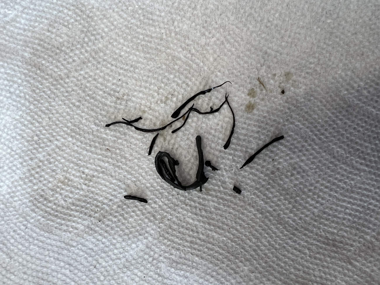

Pulled the oil pan to scrape off the screen.

Could I ask how many Kms? Just wondering when to pull off the oil pan.
Also, is the Perrin to improve steering feel?
Thanks
18K miles. No idea on Perrin steering reinforcements yet. Car's been parked since. I'll report back in after enough driving.

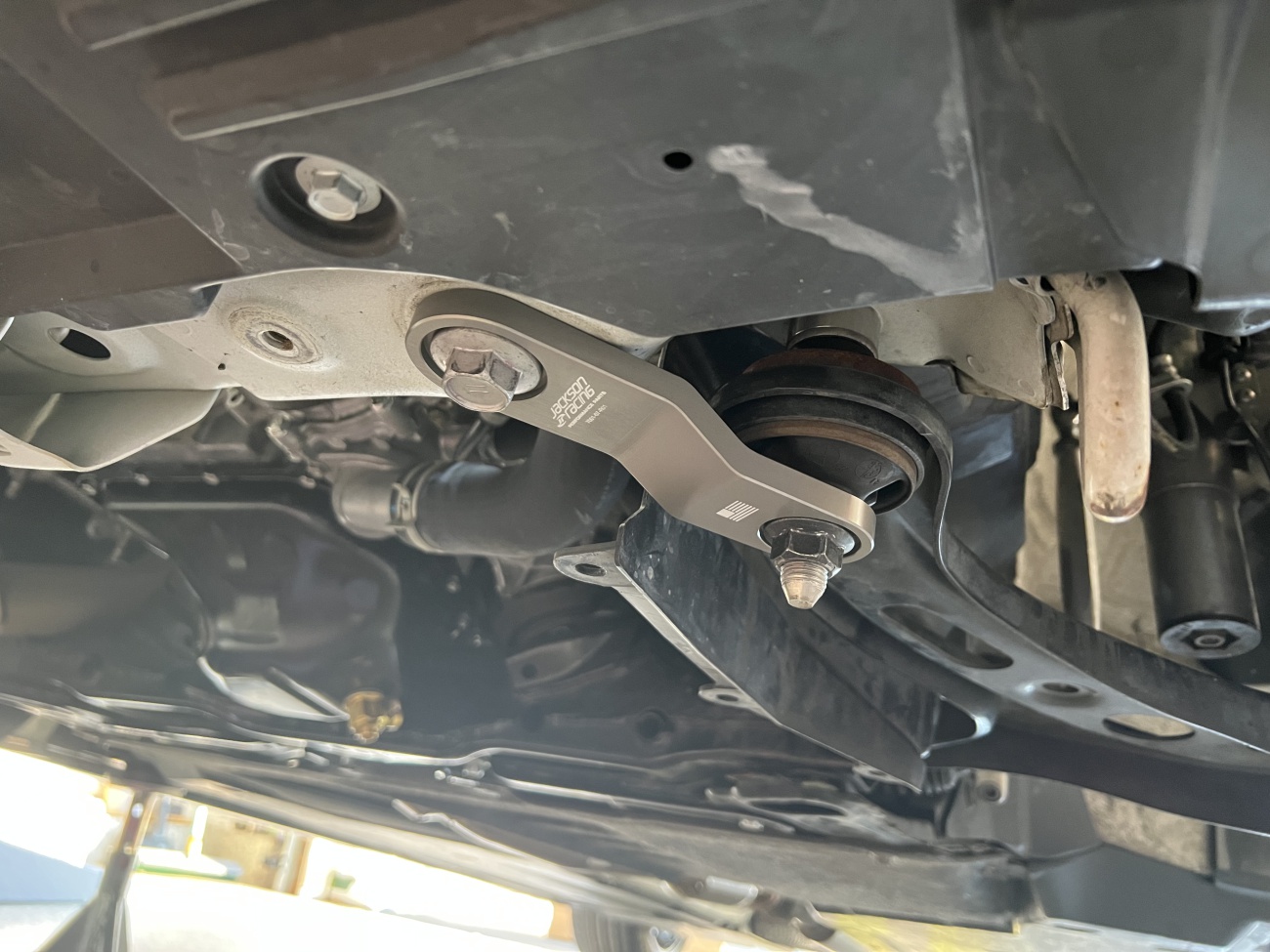

Forgot about an update for these. I installed Cusco rear trailing arms, and the GP Sports trailing arm relocation kit. I really like this mod. It makes the rear feel more compliant with the same spring rate. My car doesn’t lose traction over large expansion joints between this and dropping my rear spring rates down from 500 to 400. It used to be a white knuckle event under throttle hitting certain types of bumps.
I would have just picked up the MCA traction mod (I tried), but they are horribly backordered. I like these GP Sport ones a lot though. No noticeable NVH changes from this.
The rear subframe inserts won’t work without some creativity. I think if I drop the sway at mount and compensate with shorter end links it might, but I need to test it.

When I contacted MCA about when the traction mod will be back in stock, they said they're re-designing it and it's at least a few months out.
I have been looking at the gktech one. It's a bit different in that it lengthens the arm as well as lowering it. I hadn't seen the gp sport one before.
I looked at the GK Tech kit, and I have concerns about how the front of the traction arm is mounted. It operates at high misalignment, and I would be concerned about maxing out the spherical bearing travel. They mounted it in the wrong direction, IMO.
That's straight from GK site. I understand that's full droop, but they didn't specify on what kind of suspension. I'd rather have a traction mod that doesn't introduce this sort of concern.
