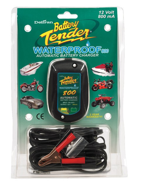

The "Battery Tender" brand waterproof chargers are the best for long-term maintaining. They are waterproof, and mine has lasted 20 years outdoors. They charge at about 10 watts, and maintain your battery at a float charge.
