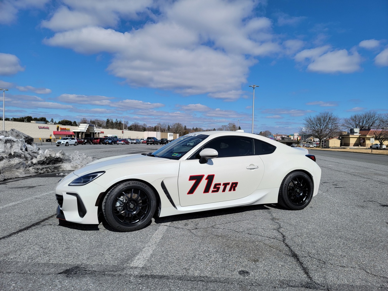

Ok, I got my 6UL on today.

Looks good! 17x8 or 17x9? Spacer in front?

17x9 5mm spacer in the front

Offset?
Any particular reason for the 5mm spacer up front?

48 offset. Spacer in the front so it doesn't rub at full lock

Thanks! Would you say this is a better offset compared to your +45 RPF1s?

I don't have RPF1 (on my BRZ) for comparison, but I am very happy with the +48 fitment with stock lowered camber and 245s. With a bit of camber adjustment 255 would be no problem in rear. You will need a spacer up front regardless. 7mm seems pretty good with about 2.5 degrees and 245s. Could easily put 255s in front.
