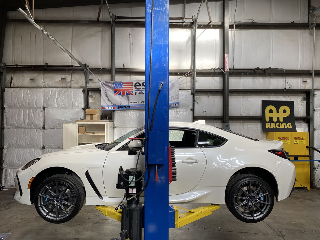

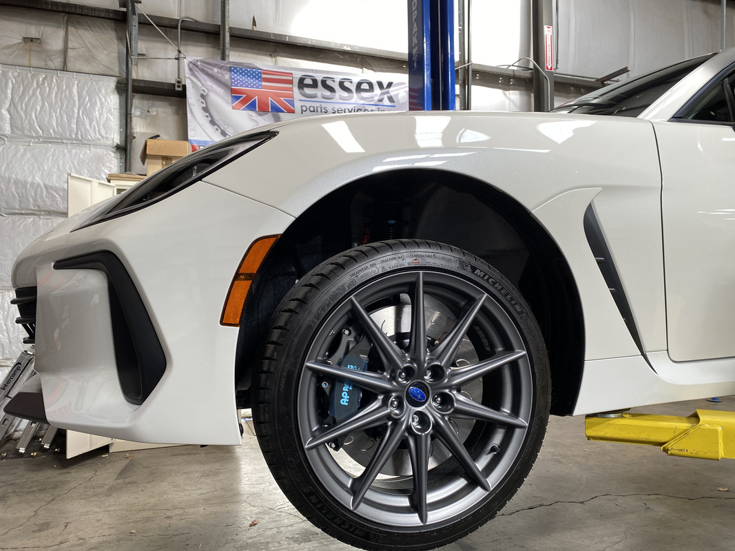

We've made some great progress this week! We confirmed that we do need a new caliper bracket in order for our Sprint Kit designed for the Gen.1 cars to fit the '22 BRZ. That design is completed and we're trying to see where we can slot it into our manufacturing schedule.
Some may consider this even more exciting...we were able to fit one of our front and rear Radi-CAL Competition Kits on the car! Our front CP9660 option even clears the OEM 18" wheels without a spacer (our front CP9668 kit will require a spacer). Our rear kit also clears the OEM wheel without a spacer and a couple mm to spare. It also retains full parking brake functionality.
If you'd like to see the details on the Radi-CAL kits, they can be found in the links below. We may need to do a new brake line, and a few other small tweaks to this system, so please nobody order these with the intent of putting them on your '22 BRZ!
Front Radi-CAL Kits
Front AP Racing by Essex CP9660/355mm Radi-CAL Competition Brake Kit
Front AP Racing by Essex CP9668/355mm Radi-CAL Competition Brake Kit
The only difference between the two kits above is the caliper. You can read about the two caliper options here:
Sibling Rivalry: Which AP Racing Radi-CAL is Right for me, the CP9660 or CP9668?
The CP9668 option uses a 25mm thick pad...a full inch thick. On one of these cars, you would possibly never need to change your brake pads ever again!
Matching Rear Kit
Rear AP Racing by Essex CP/340mm Radi-CAL Competition Brake Kit
On to the pics...

Thanks Pat! It is indeed a lot of brake capacity for this chassis. Many of the bigger, far more powerful cars highlighted on our Essex Blog are running this same setup and winning national championships. Our Radi-CAL Kit will withstand anything a built BRZ/86 can throw at it. You could run a 24 hour race with an LS engine swap, huge twin turbos, etc., and it wouldn't phase our system at all.
You know what's really cool though? We are still going to shave considerable unsprung weight vs. the OEM brakes. Despite the huge increase in thermal capacity, our front Radi-CAL 355mm kit weighs about 6-8 lbs. less than the OEM front brakes, and our rear kit will weigh in the neighborhood of 3-4 lbs. less.
