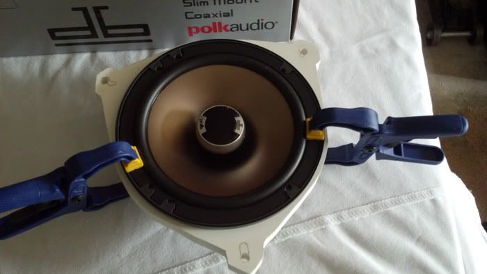

Phenryiv1's spacers fitted perfectly
And thank you Pkenryiv1 for recommending the Metra 72-8104 speaker wire harness ... it connects perfectly into the factory plug.
Here are a couple of pics from my install.
I used the clamps to hold the speaker in place while I drilled the holes to mount the speaker to the spacer.
