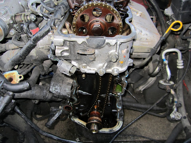

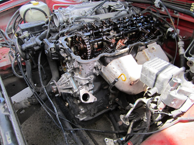

i replaced the timing chain today. i'm really glad i did because if i had driven the car with the bad timing chain guides, i would have caused A LOT more damage. on to the pictures...
just getting started...
valve cover, distributor, a/c, p/s pump, thermostat, crank pulley all removed.
timing cover is off. see the problem?
a closer look. those two allen bolts should have a guide between them.

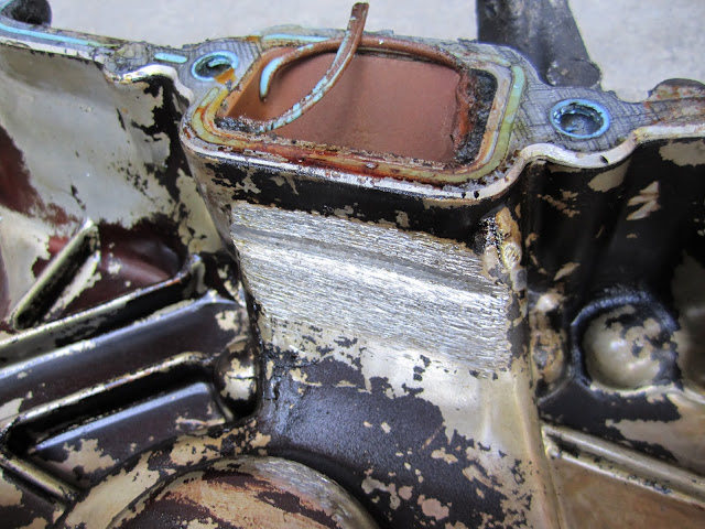

here's the inside of the timing cover where the chain was chewing away toward a coolant passage.

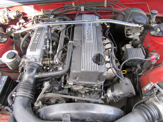

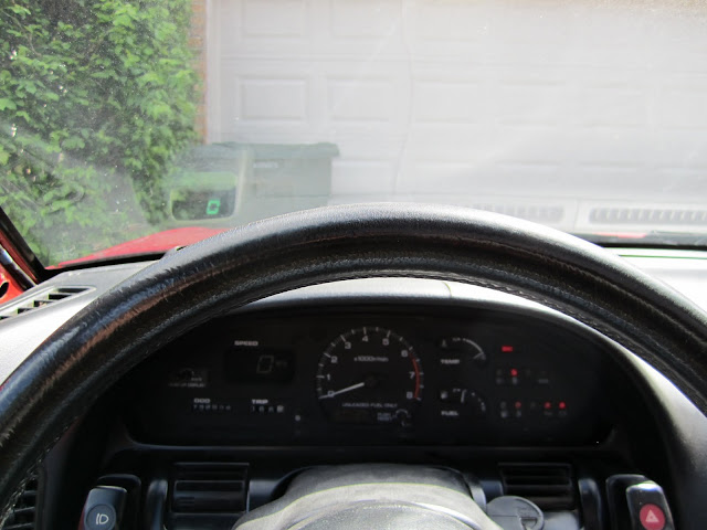

new alternator is in. oil is changed to Rotella 15w40. i tracked down an intermittent cylinder #4 dead misfire to the injector wiring. it's sort of fixed for now, but i think eventually i'll wire in a new harness connector. only thing left to sort out is the high idle. also, did i mention that the HUD works???
it's hard to see in the picture, but you can see the 0 on the windshield.
finished engine pictures:

so about $230 and a few hours of my time and it's turning out to be a pretty decent here-to-there car. only things left to do really is figure out the headlight issue. i'm pretty certain it's the multifunction/headlight switch on the steering column, so i'm gonna swap in a known-good switch and see if that fixes it. if that's the problem, a new one is $75-90, or i could try to source a used part for cheeeeap.

Sweet!
Is that HUD oem? I never knew they had them.

yep, it's an OEM HUD. it's actually pretty cool, and works well. also, i can switch it from mph to km/h if i feel like it, haha.
the original timing chain guide design was all plastic, so after 20 years it got brittle and broke into pieces, leaving only those bolts. the new design is a metal guide with a plastic face, so that won't happen again.
