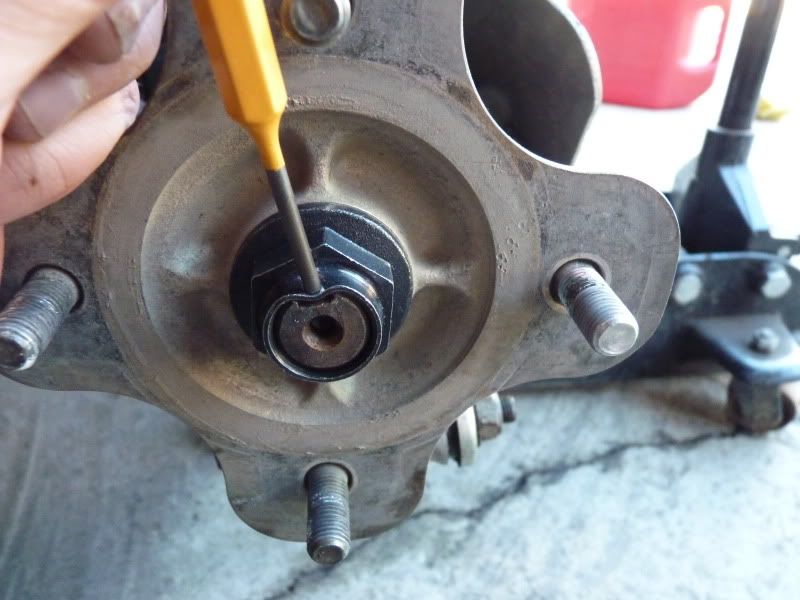

Originally Posted by Yoda View Post
Is there like a Subaru shop manual that shows the replacement of the axle nut. They are telling me it's fine the way it is not being staked and the cotter pin is the only thing needed to hold it in place. I want to believe them but rather double check.
I replaced an axle myself and peened the new axle nut myself. With the slightest experience and the right tools it's a 2-2.5 hour job. The dealer cheesing out on a 3 minute process tells me you're going to the wrong mechanic.
If you must have a dealer do the work, take it to another dealer and tell them you want that axle nut peened properly. The other 3 will be peened from the factory, why is the current dealer telling you the new one doesn't need to be?
The reason why you want that peened is that the torque spec for the axle nut is only 140 ft.lb. From what I understand that's not much torque for an axle nut (some cars torque this upwards of 180-200 ft.lb. So the nut can back out given the tremendous twisting forces and vibration on it.
Not my car, but seriously, this is all they have to do.

Tell them you need a new nut. Tell them to replace the nut, or you will file a claim with Subaru North America. It's a common Subaru problem. It happens with every WRX, STI, Legacy GT, anything they make that makes power has crappy axle nuts.
The dealer doesn't pay for the nut, they bill Subaru. It's fricking $6 nut...Tell him he's wasting your time, his time, and the tech's time and to just replace the nut. You CANNOT re-torque the nut. Once and done. These nuts night as well me made of pewter. They are super soft. I had one torqued to 145 ft lbs, FSM says 141, and it still clicked. Put it in the trash and got a new one and it stopped clicking.
Don't let them diagnose it. They're going to wussyfoot the car around the block and tell you nothing is wrong. Don't act like you don't know what you're talking about, or they'll just assume they know everything and you know nothing. Go in, tell them what's broken, how to fix it, and to get the job done.
This is what the axle nut click sounds like:
[ame="https://www.youtube.com/watch?v=PpjrnQQC8ac"]BRZ Axle Nut click - YouTube[/ame]
