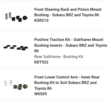

Looking into these right now. Should cover most of allowable mods for DST.

For the positive traction kit you don't want to install the very front bushing. The NVH is supposed to be pretty bad. So just a heads up.
I did a small post about it in my build thread. Oh and sorry if I am thinking of the wrong bushing kit but from the picture it looks the same lol

Whiteline goodies ordered.
That makes it to the following to-do list:
- Steering Rack Bushings
- Rear Subframe Bushings
- Transmission Mount (STi)
- Front Lower Control Arm Bushings
- New OEM Front lower control arms
- New OEM Tie rods
- Engine Mounts (STi)
Still on the hunt for the STi LSD mount. I have the whiteline kit, but rather replace the whole thing.
