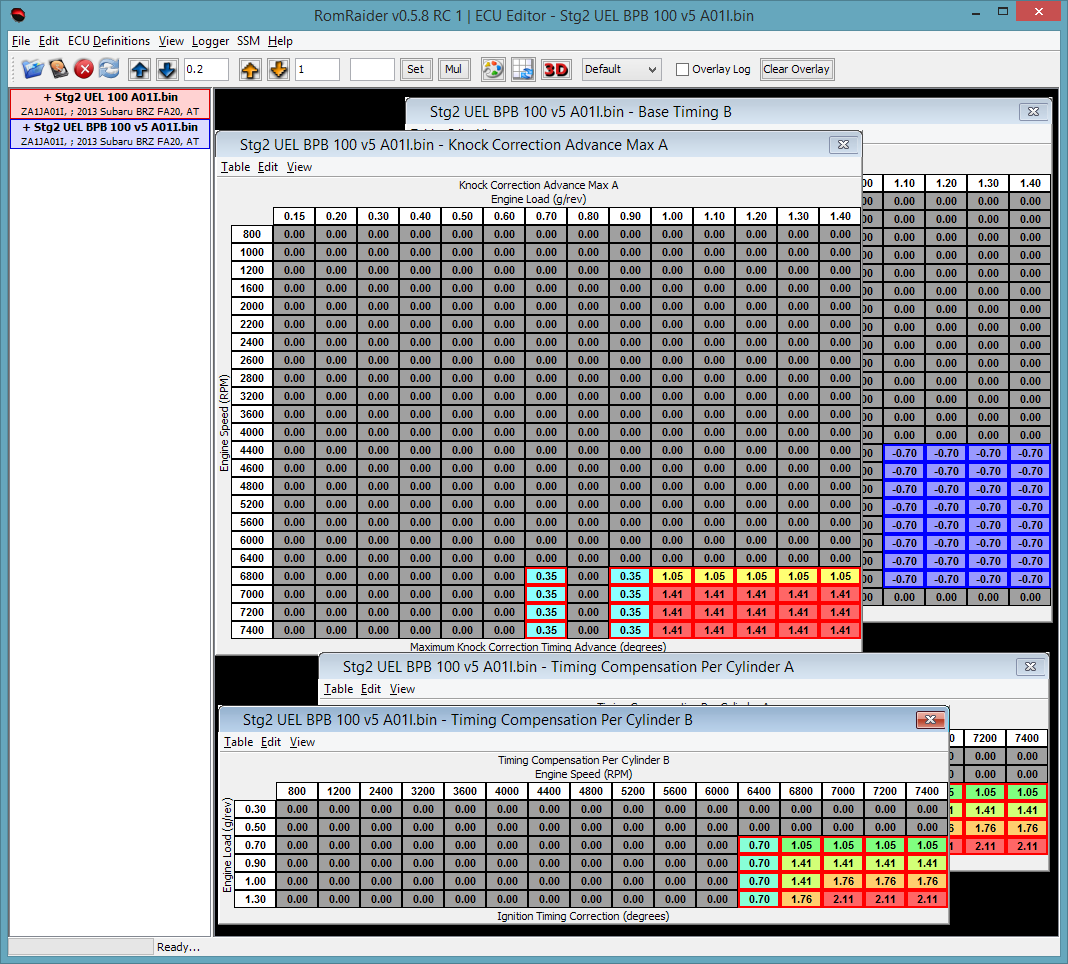

Finally got rid of the knock with the intake runners, basically the same as P100 map but with less timing at 5000-6000rpm and put the per cylinder compensation back in.
P0420 removed on all maps.
Knock prevention for high intake air temp on all 98RON/P100 maps.
Knock prevention for high coolant temp on all 98RON/P100 maps.
Un-neutered cold starts to wake the dead.
Modified radiator activation temps for idle.
Soft rev limits.
Stg1 98 - Steve's map for 98RON.
Stg1 100 - 91AKI map for United P100.
Stg2 EL 98 - My map for 98RON.
Stg2 EL 100 - OTS 91AKI map for United P100.
Stg2 EL E85 - OTS E85 map for United P85.
Stg2 UEL 98 - My map for 98RON.
Stg2 UEL 100 - OTS 91AKI map for United P100.
Stg2 UEL E85 - OTS E85 map for United P85.
https://www.dropbox.com/s/zr1g82z5zg...11-01.zip?dl=0

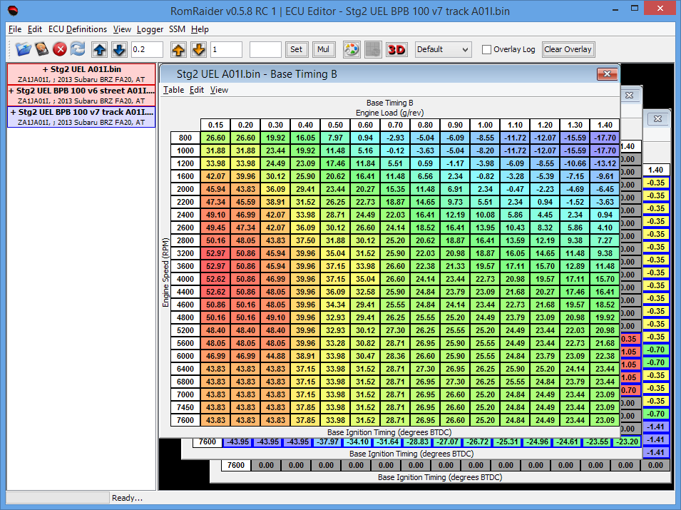

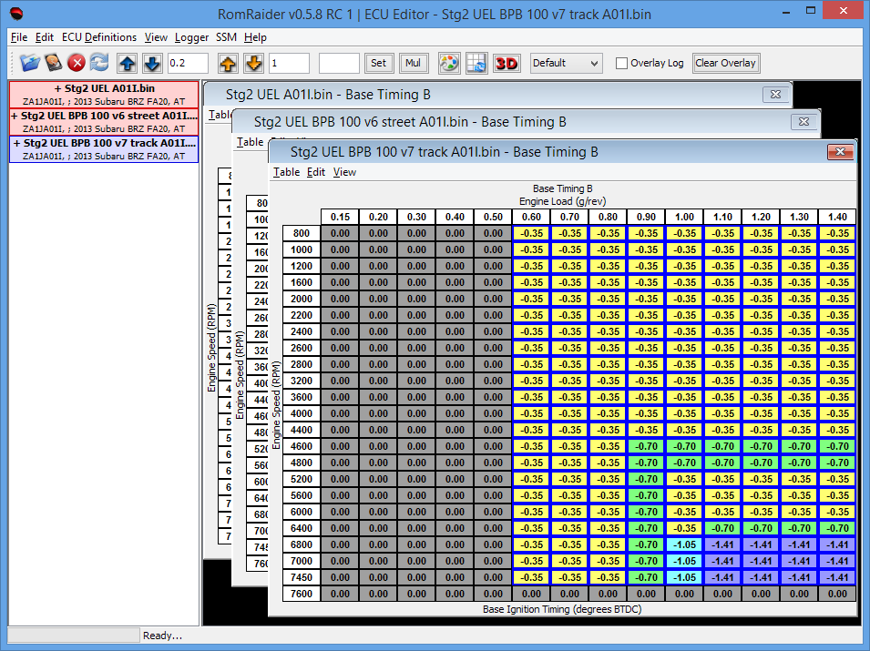

Intake runner maps for our shitty, shitty fuel.
I'd recommend "Stg2 UEL BPB 100 v7 track A01I.bin". You could run 98 on it as long as you switched to P100 for the track.
Only need to copy Base Timing B. They keep the PCC tables unmodified.
https://www.dropbox.com/s/b5avqtbhm3...11-02.zip?dl=0

Mentioned: 211 Post(s)
You can compare mine to of the shelf 2.0 A01I to find all the modified tables.
