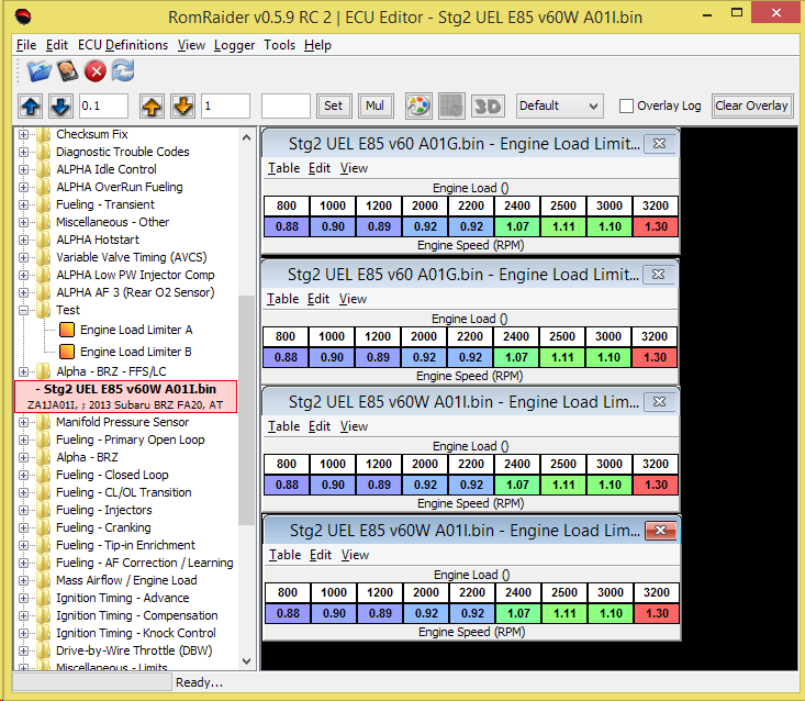

Ok, I've taken @Kodename47's 4 addresses for those tables, copied the hex from the A01G rom and the exact same hex appears in the A01I rom at the exact same location, so got extremely lucky there it seems.
Now the only question is - what values to use?
Code:
	<table name="Engine Load Limiter A" storageaddress="1047CC">
	 <table type="Y Axis" storageaddress="1047A8" />
	</table>
	<table name="Engine Load Limiter B" storageaddress="104804">
	 <table type="Y Axis" storageaddress="1047E0" />
	</table>
Code:
	<table type="2D" name="Engine Load Limiter A" category="Test" storagetype="uint16" endian="big" sizey="9" userlevel="3">
      <scaling units="Engine Speed (RPM)" expression="x*0.0000610351563" to_byte="x/0.0000610351563" format="0.00" fineincrement="0.1" coarseincrement="1" />
      <table type="Y Axis" name="Engine Load" storagetype="float" endian="little" logparam="P2">
        <scaling units="" expression="x" to_byte="x" format="#" fineincrement="100" coarseincrement="500" />
      </table>
      <description>Engine load limit against RPM.</description>
    </table>
	<table type="2D" name="Engine Load Limiter B" category="Test" storagetype="uint16" endian="big" sizey="9" userlevel="3">
      </table>
    </table>
1047A8-1047CB
L:24(36)
44 48 00 00 44 7A 00 00 44 96 00 00 44 FA 00 00 45 09 80 00 45 16 00 00 45 1C 40 00 45 3B 80 00 45 48 00 00
1047CC-1047DF
L:14(20)
38 52 39 9A 38 F6 3A E1 3A E1 44 7B 47 0A 46 66 53 33 00 00
1047E0-104803
L:24(36)
104804-104817
L:14(20)
1047A8-104817
L:70(112)
44 48 00 00 44 7A 00 00 44 96 00 00 44 FA 00 00 45 09 80 00 45 16 00 00 45 1C 40 00 45 3B 80 00 45 48 00 00 38 52 39 9A 38 F6 3A E1 3A E1 44 7B 47 0A 46 66 53 33 00 00 44 48 00 00 44 7A 00 00 44 96 00 00 44 FA 00 00 45 09 80 00 45 16 00 00 45 1C 40 00 45 3B 80 00 45 48 00 00 38 52 39 9A 38 F6 3A E1 3A E1 44 7B 47 0A 46 66 53 33 00 00

Was just about to post those A01G defs for you. I had pulled them from the OFT .xdf tuner pro defs that Shiv released orignially (A00C).
Seems that bit of code is not used in AT if it is showing 1.4g/rev load (unless the logged valued used is before it gets cut by the engine load limiter). Which parameter address are you using to log load?
I have logs from my A01G ROM showing 1.3 g/rev (and lean) under boost!!! My engine load address = 0xFFF89148

If anyone doesn't have any advice, I'll try this I guess, along with returning to OTS MAF scale.
Unfortunately never logged MAF g/s so don't know what to set the MAF limit to.

I feel like I'm getting close.
http://datazap.me/u/wayne/v49-12-dyn...4112-4137-4160
- Increasing the load limit to 1.4 over 2400rpm should make the 2400-3000rpm region not lean out. Just increasing the 3200+ helps in the real world but wasn't enough for unrealistic dyno pulls.
- I'll adjust 3000-4000rpm with -8% MAF scale at 3.2V, which will make that region go a lean if I'm ever unlucky enough to hit 3.2V in open loop while not at WOT.
http://datazap.me/u/wayne/v37-1?log=...-2895-2903-398
