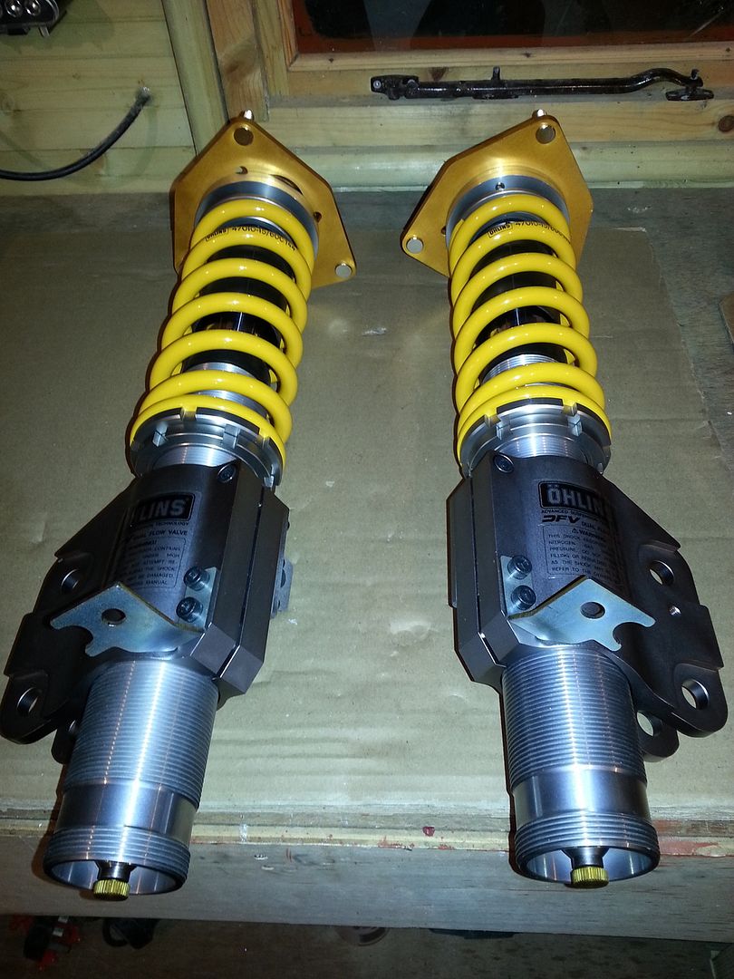

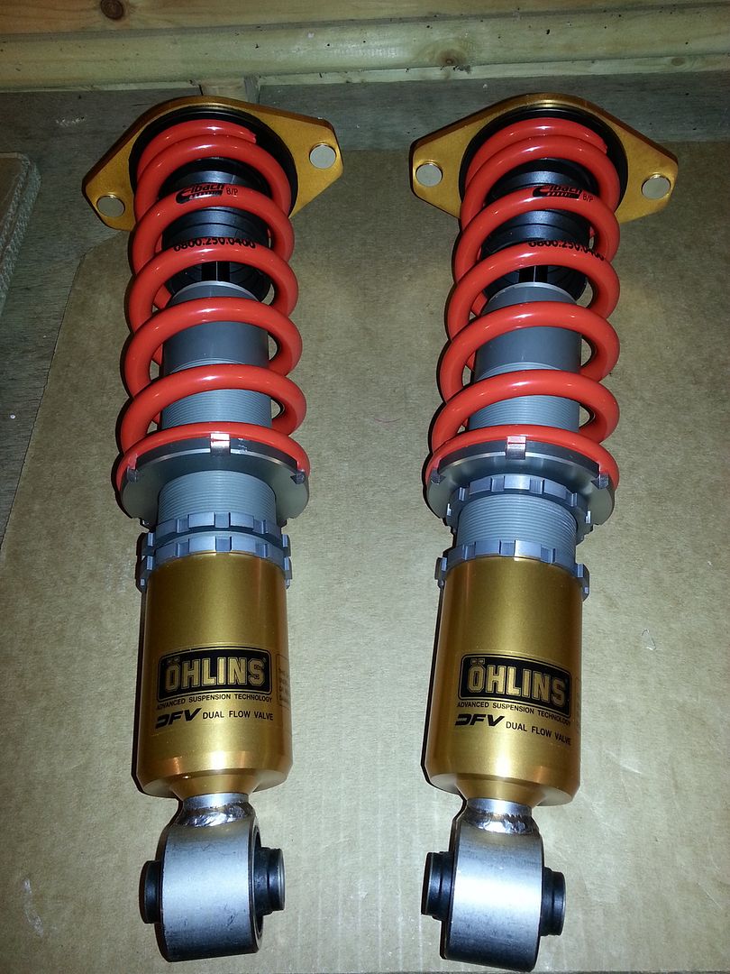

FWIW I didn't use any threadlock on mine. I put the fronts on today, set at Ohlins' factory height and they dropped a LOT lower than I expected, a bit over an inch lower. I'm waiting for the Eibach springs to install the rears (and I blew a few hours messing with one of the factory end links, destroying it in the process) but they should be here tomorrow.
First impressions just from installing the fronts and with no front sway bar... Very OEM like ride quality. They do make a "woosh" noise over bigger bumps (like speed bumps) which was unexpected. Nothing bad to report, super easy install too.
edit: Linking to the post I made about today... Factory end links are horrible, for the record. http://www.ft86club.com/forums/showp...ostcount=13327
im going to see how far I get with stock end links. If they they are stuck ill get some whiteline ones.
400lb rear springs

I finished installing my Ohlins today and aligned the car. -2.5 camber up front and -2.0 in the rear. About 1/32" toe in front and rear. Set the dampers to 15 clicks front and rear and took it for a few short drives. For being so much stiffer springs than stock (I'm using 60N/mm front and 70N/mm rear, same as ajc209) the ride is sublime. WAY better than the KWs on my GTI. I'm excited to get some miles on them now
BTW I'm going to use OEM links for now. Might change to Whiteline end links if I change the anti-roll bars. I'll have a replacement for the one I destroyed sometime this week.
