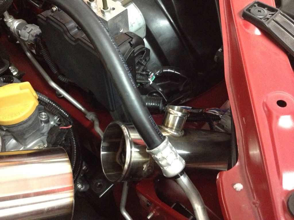

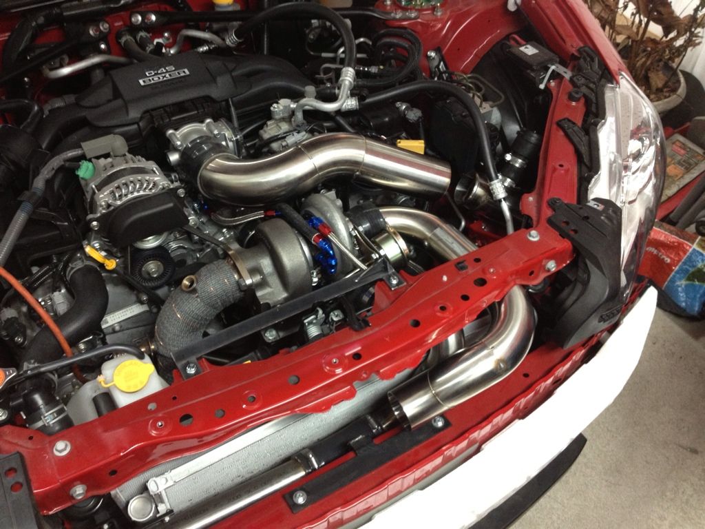

I finally welded my BOV adapter and installed it! I also built my turbo inlet pipe and ordered my K&N filter. I will be welding the inlet this week and once the filter shows up i can put the bumper back on for good!

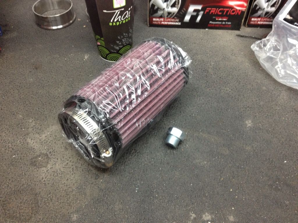

Not much to brag about but i got my air filter and wideband o2 plug. As soon as i get my maf housing from treadstone i can drive!
