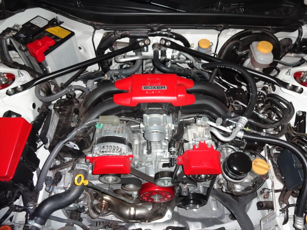

Originally Posted by Sportsguy83 View Post
Do you have a LW Pulley? (Just curious)
Yeah I'm running an Agency Power lightweight pulley, you can see it down there:
Just asking because I have one and will have FI in about March/April. Your car is amazing all the way! Awesome job man.
