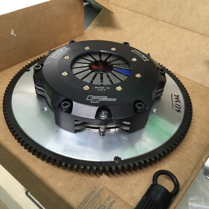

Final part before tuning. Custom fx725 twin disk for the tremec

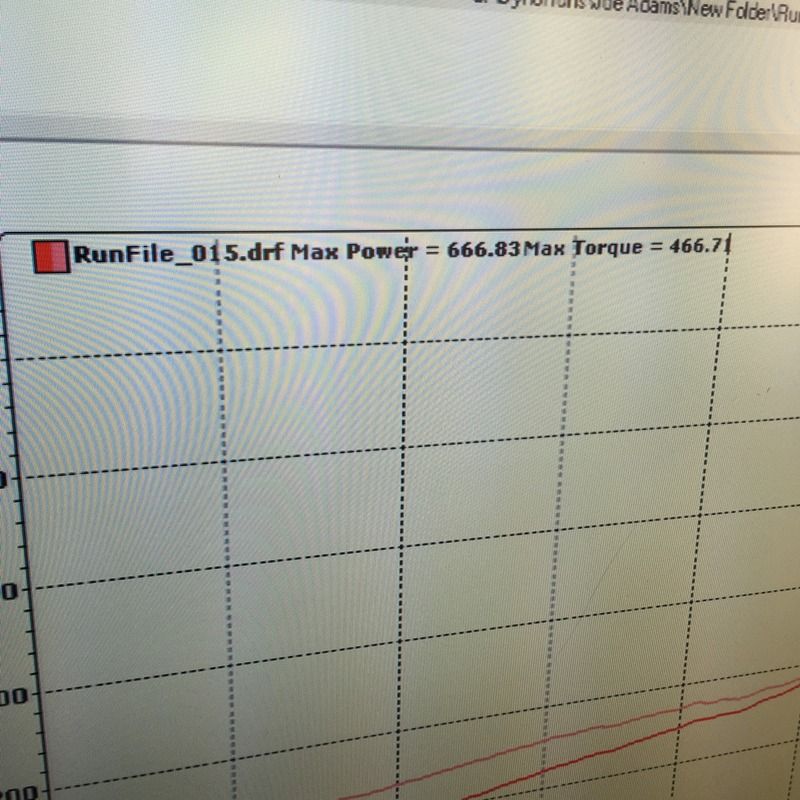

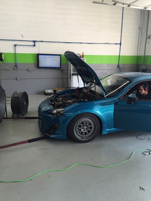

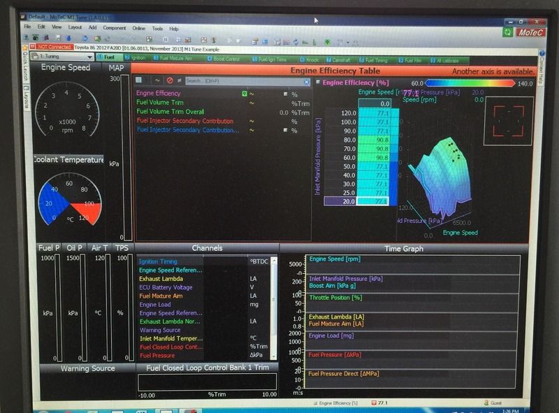

Finally got the motec in and started tuning today. Ran out of injector at 28psi of boost. Going to swap those out and continue hopefully next week. Also have to wire in the anti lag switch and configure the motec shift light module

Wow ahah get any good numberso on the dyno? And I've been wanting to do motec on mine but damn it's pricey aha it's about 5k correct?

Never mind just looked at it damn 666whp how's that trans doing? And is that a sequential!!?

666 at 28 psi. the turbo will probably start to run out of steam around 38ish from what he could see. new injectors are going in and hopefully he can swing by next week to finish up. the control and drive ability of m150 ecu is amazing. the fuel trim controls are so quick to respond the afr is dead on with commanded afr the whole time. the high pressure di pump started oscillating fuel pressure after 8k rpm from 600 psi to 2000psi until redline. im assuming with ecutek people just leave it be but with the m150 it corrected the duty cycle for the di's so fast the afr had zero deviations from commanded after 8k.
trans is fine. it is faceplated (basically dogbox) H pattern 5 speed. its rated for 600 continuous ft lbs in stock form from tremec. mine has heat treated gears so they have a tad more give from shock load. we might setup a strain gauge for clutchless shifting at the track seeing how the trans will take it with the control the m150 has over clutchless shifting loads.
