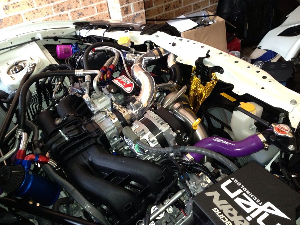

Today's progress:
Installed bigger fuel pump
Installed bigger injectors
Installed 3 bar map sensor
Hooked up turbo coolant lines
Mocked up the last of the I/c piping.

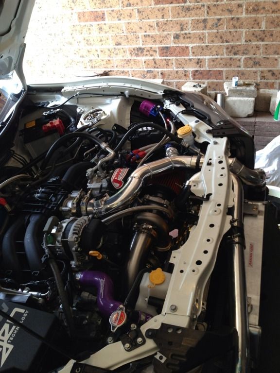

Finished all the intercooler piping today. Made me a bit happier that its all over lawl. Also added the BOV and hooked up the vac line as well as the wastegate.

Have not yet received the turbo bag (DEI titanium) but the dump pipe will be wrapped, I'm plumbing it into the stock over pipe for now until I get some time to build the rest of the exhaust. I just want to be able to take it for a spin and check everything is doing what it should and doing it well.

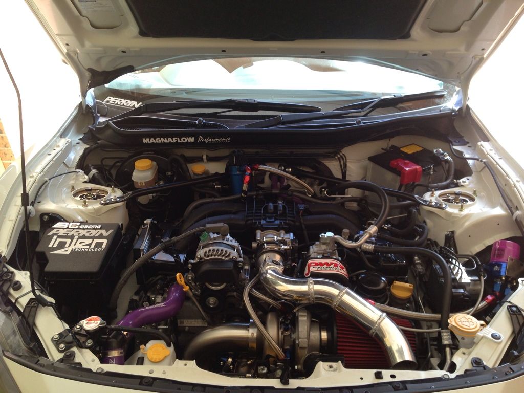

It runs!
I have plumbed the turbo dump pipe into the stock overpipe and stock exhaust. It's quieter than stock apart from a crazy loud whistle and the wastegate dump. Currently it's running very very rich. Waiting on an update from Visconti with some tune tweaking but all in all it's working as it should
