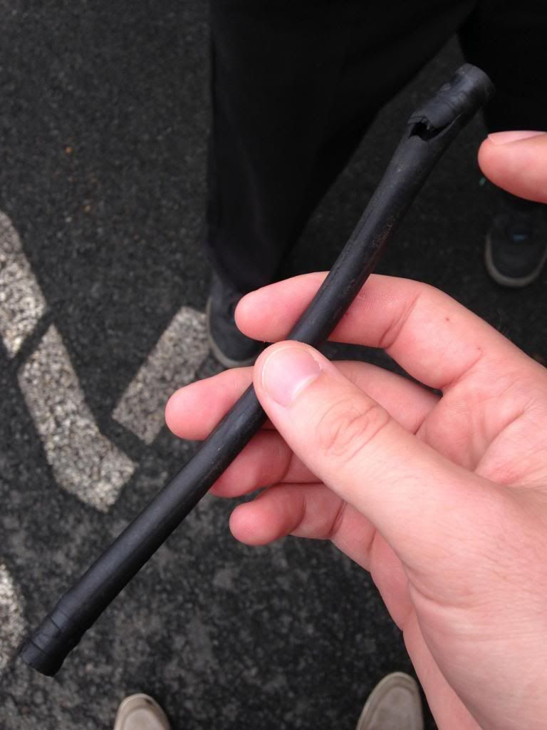

I posted this in my build thread but I thought I'd share it directly here as I think it's pretty useful info. I was having an overboosting issue that I didn't discover until today on @ptuning's dyno.
So the overboosting issue was caused by the following broken hose:
This little bastard was hooked into the turbo directly. I can only assume it was responsible for feeding to the wastegate. Since it was broken right at the turbo this meant the air pressure never reached the gate and therefore never caused it to open.
My car built boost continuously. Toan @ptuning never let it get too dangerous but noticed there was an issue when I was making over 300 hp at around 5500 RPMs. He's going to send me the dyno plots for comical value.
Thankfully we caught this when we did. I learned a couple things here:
1. GET A @#$%ING BOOST GAUGE!! Even my "safe" 5 psi tune could have had catastrophic mechanical failures which very nearly lead to engine grenade. I would have known something was wrong if I had a boost gauge. I know this is obvious but I felt like reiterating the obvious since I didn't do the obvious...
2. This was the reason I "needed" a new clutch. I was making tremendous power and didn't even realize it. A stage 1 tune with the stock clutch might be just fine after all.
3. THIS ENGINE IS AMAZING. It put up with this unbelievable punishment without knocking or showing any signs that something was wrong. I was pushing 12+ psi on pump gas with no fueling system upgrades. I DO NOT recommend doing this permanently, but I must say I am thoroughly impressed and relieved that this wasn't a blown motor.
I'll post the dyno plot when PTuning sends it to me. I was on track to make nearly 330 whp lol. Don't know what the torque numbers were yet but boy was that a surprise....
