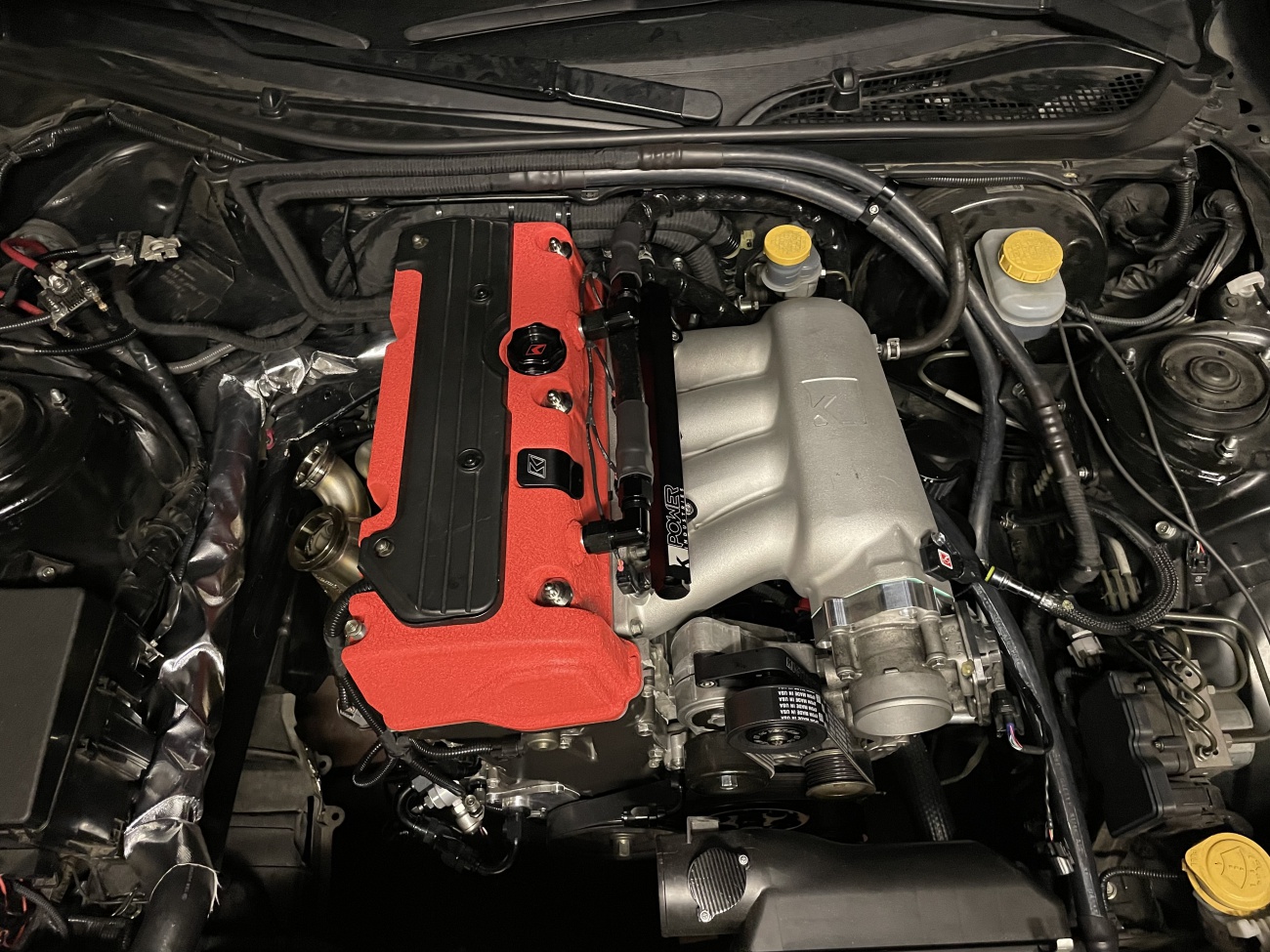

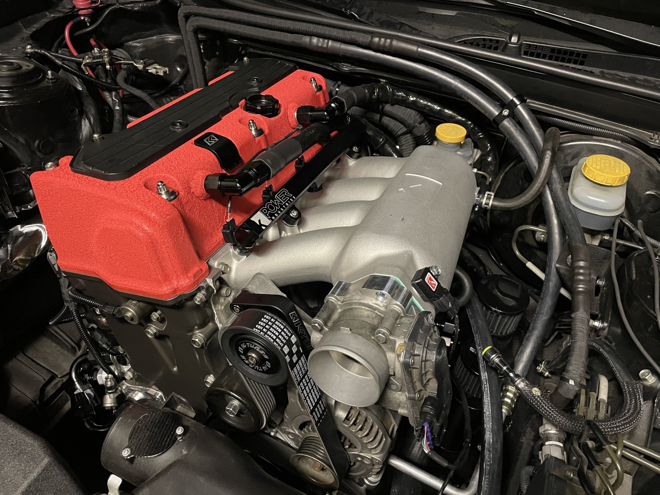

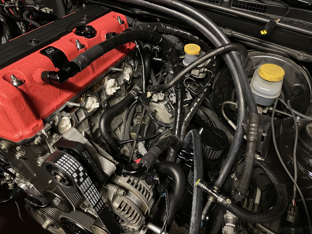

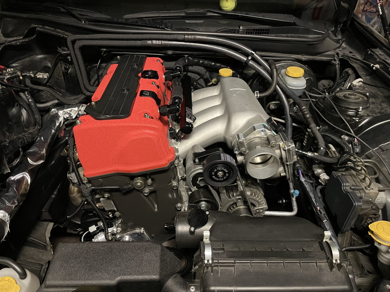

I finished the driver's side of the engine bay, besides a few details that will need to wait until the rest is complete. For instance, I hooked up the vacuum lines, but I need to finish the BOV/IC pipes before I can route the line. Stuff like that.
The clearance on the intake and TB is fine. I should be able to fabricate a 3'' IC pipe that will clear the hood and route around everything.
Speaking of clearance, the hood and TB do touch the hood insulation pad. Hopefully it isn't a problem.

That top cover is a thing of beauty.
