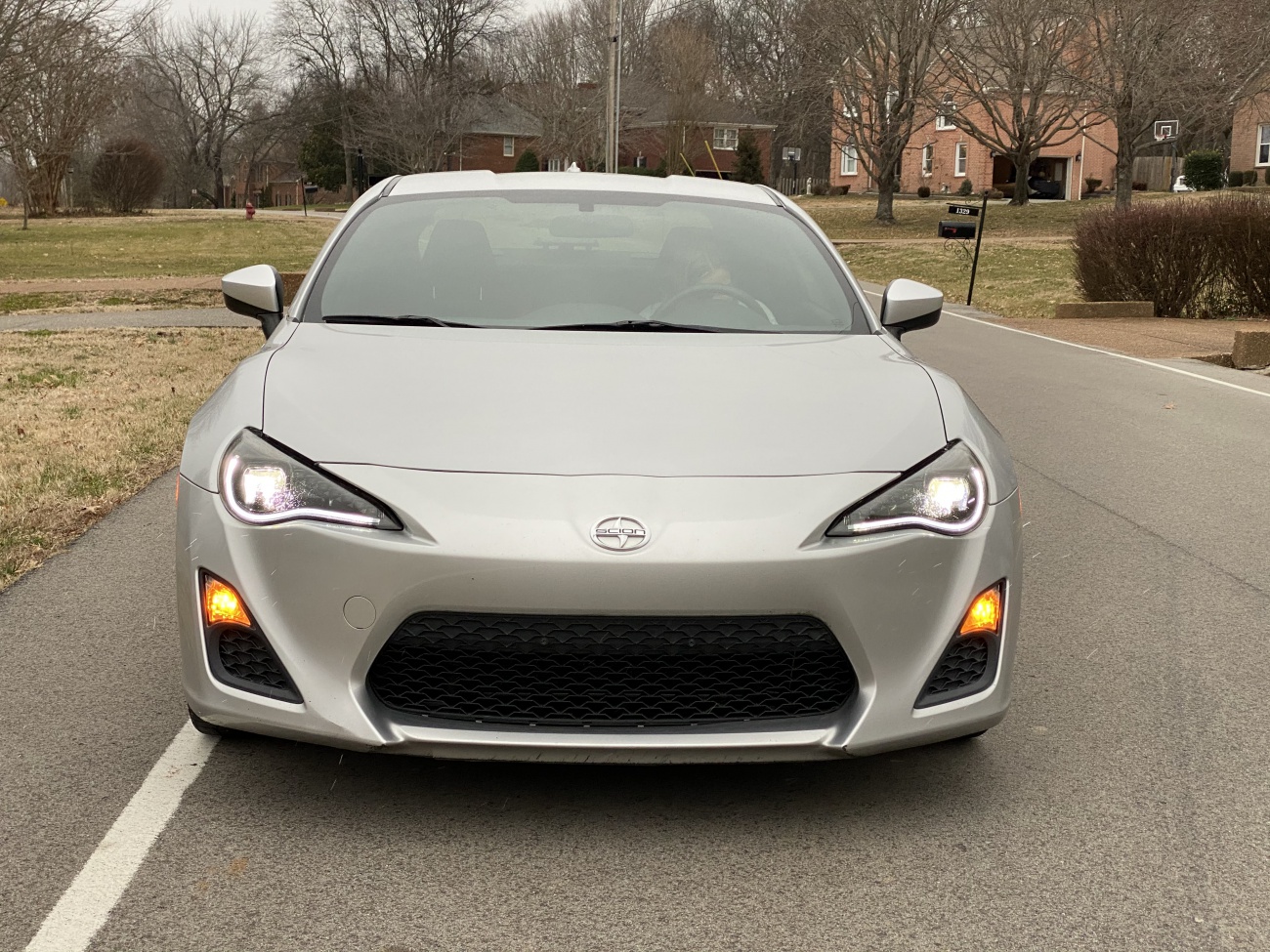

Got these, such an improvement over FR-S stock halogens. I don’t feel like I have old flashlights for headlights anymore, and can actually see down the road.
