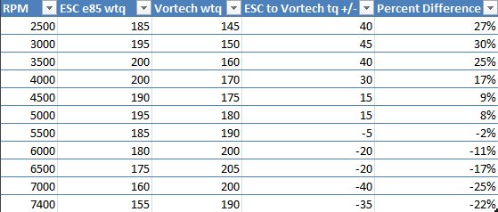

Did a quick area under the curve comparison:
Attachment 85677
Hi Fenton, since the ESC competes more directly (on price) to the Stg1 Innovative kit (non-intercooled) do you mind running the same analysis against an "average" one of those?
http://www.ft86club.com/forums/showthread.php?t=40066
agree hp is dead on

Originally Posted by fenton View Post
Looks like the torque crossover is at 5500rpm ~. Phantom would feel quicker from 2000-5500 and vortech faster from 5500-7400.
When shifting at WOT i think the rev's drop to about 5000rpm if im not mistaken so Vortech would drop to 175hp and phantom to 185hp.
I think the race would be closer than some think especially through the first 3 gears. I dont doubt that vortech would start pulling in 4th and 5th.
Well shiv looks like you have some work to do, time to do "comparison" video with both cars either from a dig or a 3k rpm rolling start
I think we need to somehow add a dyno plot with just the drag reduction on to compare all aspects - i.e. part throttle driveability. The vortech should be quite a bit peppier than stock above 3K rpm at part throttle as it's providing boost even at part throttle - the ESC is doing something as well with the DR, but it's hard to say how much DR by itself does.
In the end, probably a back to back test, both subjective and maybe a couple drags would be the best way to compare.
