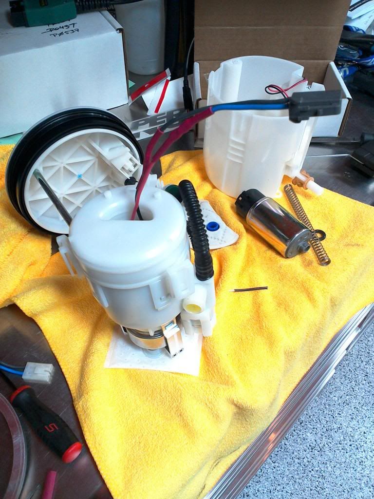

Guys, my tuner has just gone to fit the FBM 485 pump kit and is concerned as it doesnt seem to fit properly. It just seem to float around in the bottom of the tank (his words). Any suggestions or a link to some install instructions ? Just like my JDL turbo kit FBM didnt ship their pump kit with any instructions
I don't have the FBM 485 kit but this was covered in the FBM thread because someone else had questions. Apparently the clips which hold the canister together aren't clipped anymore, the assembly does kind of just sit in place once it's all assembled, the pump is held in place by the billet clamps part of the kit.
Few other things:
The JDL exhaust doesnt reach to the pipe work after the turbo (could it be because my header didn't fit properly and is causing other issues further down the exhaust line so to speak??).
I still haven't received any water fittings for the turbo.
The 3 inch over/front pipe doesnt fit and is having a crease put in it later today (just as we had to do with the header as it was hitting the engine block).
I cant expect my installer to keep pushing my car around getting it in and out their workshop every other day. Fuck knows what my labour bill is going to be, car isnt even close to getting on the dyno yet. Anymore grief and I can see the lot coming off and going back to Phoenix in a big box at this rate.
Some support would help. Jesse are you there? I've sent a few emails and no reply....
The FBM 485 bowl no longer clips together but floating around is a far stretched reality when actually installed in the tank. The stock pump assembly is MUCH shorter overall so the bowl is required to be clipped together in order to prevent everything from coming apart. On the FBM 485 kit the whole assembly becomes longer so when installed there is literally zero movement because now the pump assembly is sandwiched between the bottom of the tank and the top.
Although I agree that they technically could have made it to where it all clamps together similar to stock or provided instructions, I can assure you the pump asseembly does not float around
