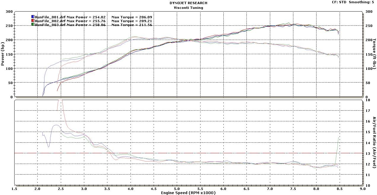

Here's the dynosheet from the P&L car I did the other day
