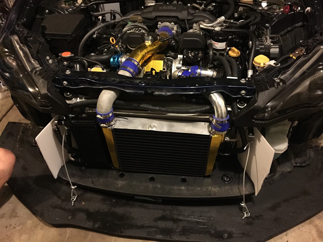

Got the cooler in. Looks really good, and feels solid.
Plans for mounting are as follows:
That should move the most air over the cooler, and allow me to run the air guides on the side to help move air through the coolers and not around them into the bumper.

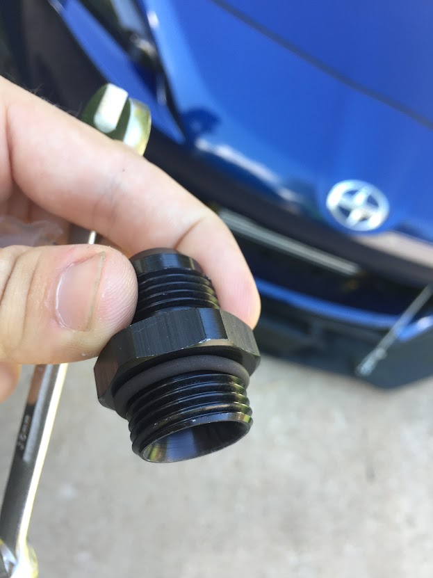

The fittings that came with the cooler even came with an o-ring. Which I wasn't expecting.

Edit: Got some supplies at lunch. Still have to drive 30 minutes out of town to get an extra quart of oil. Plastic should help guide air into the coolers, and keep leaves out of my engine bay. The wood glue is because my splitter is splitting do to the glue wasn't applied thick enough. I thought it might happen, just wasn't sure when. Should be good to go after this.
