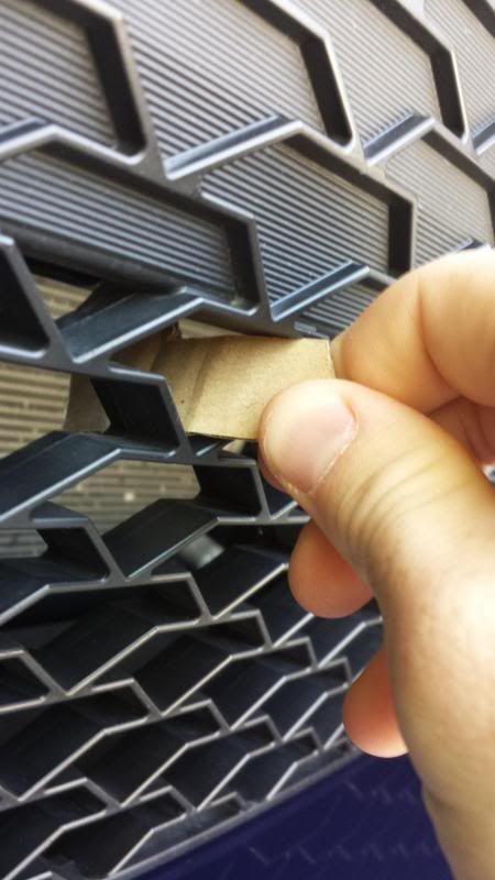

I'm not sure the braces will work with the FR-S grill. I will run some FEA to see how thin I can make that part without breaking/bending the aluminum but I can't promise anything.
A new batch of splitters should be ready in a few weeks and then the splitter ties should be ready early/mid August. Still in the quoting phase but will start ordering next week.

I'm sure you meant to say "I'm not sure the braces will work with the FR-S grille without modification." Right? Because a Dremel against that thin plastic would be like a hot knife through butter. And the grille, as I have previously mentioned, is removable and only $35 as far as needing to go back to stock goes.

That is exactly what I meant. I have since shrunk that bracket down an 1/8th of an inch in an effort to fit through the grill. It will be a close fit but I can't shrink the bracket any further.
