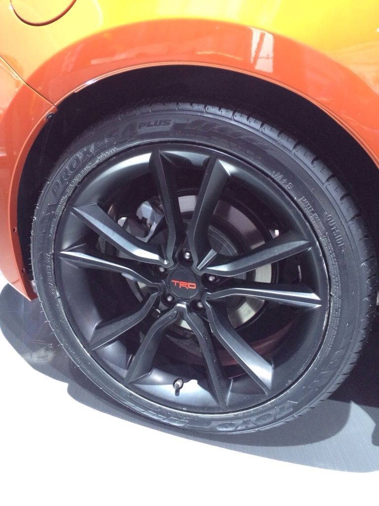

Old 10-05-2014, 04:21 PM   #179
calmtigers
Drives: 2014 Whiteout TRD FR-S 6MT
Location: Fresno / DTLA
Posts: 928
Thanks: 628
Thanked 376 Times in 214 Posts
anyone have pics of the TRD USA wheels on a white FRS?
Thanks

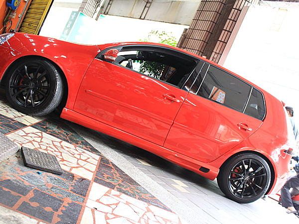

I found these ABT ER wheels..........
86Toyobaru is offline   Reply With Quote
Sorta similar

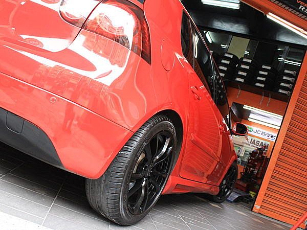

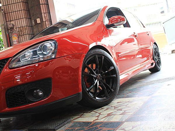

I think there are two difference if you take a close look. One is the bolt location and the other is lip pattern. Other than that they almost look the same. Size 18X8J +35/+45.
Some pics
