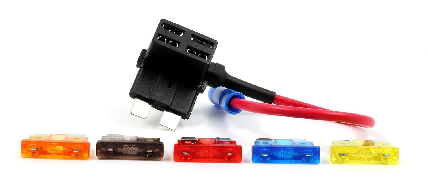

Old 07-03-2019, 12:22 PM   #180
HeresMyMind
HeresMyMind's Avatar
Join Date: Oct 2017
Drives: 2013 WRB BRZ Limited
Location: CT
Posts: 348
Thanks: 33
Thanked 167 Times in 94 Posts
Originally Posted by EndlessAzure View Post
Anyone have experience wiring the DRL for Monogram Headlights on Base FRS? I'm doing it on my 2014.
Most guides tell you to tap into the DRL resistor. (e.g. http://www.ft86club.com/forums/showthread.php?p=1012406 and http://www.ft86club.com/forums/showp...8&postcount=22)
However, the resistor gets power directly from high beam ground (after it has already passed through the headlight). The DRL works like factory, but now it triggers the highbeam flap when running DRL. The exact problem is detailed here (www.ft86club.com/forums/showthread.php?t=87959)
Am I doing something wrong? Is there an alternate method to get this working?
Your best bet is to run your own power to the running lights. Use a fuse Tap and run it into the inside of your car. it will look like the picture below. This would allow you to give them their own fuse, and trigger them to turn on from something else, I used the fuse that goes to my heated seats. so anytime the heated seats Could be powered on/off then they will be on. Which allows them to be on as soon as the ign is "on". You could also put it to the headlights if you only want them on then.
-B
HeresMyMind is offline   Reply With Quote
Old 07-03-2019, 10:31 PM   #181
EndlessAzure
Wheels for Brains
EndlessAzure's Avatar
Join Date: May 2017
Drives: '14 FR-S [37J] | Daily/Track
Location: Los Angeles
Posts: 942
Thanks: 121
Thanked 647 Times in 395 Posts
-B
I ended up tapping the HiBeam Power upstream of the headlight and adding a diode http://www.ft86club.com/forums/showthread.php?t=135275
The source is already fused
