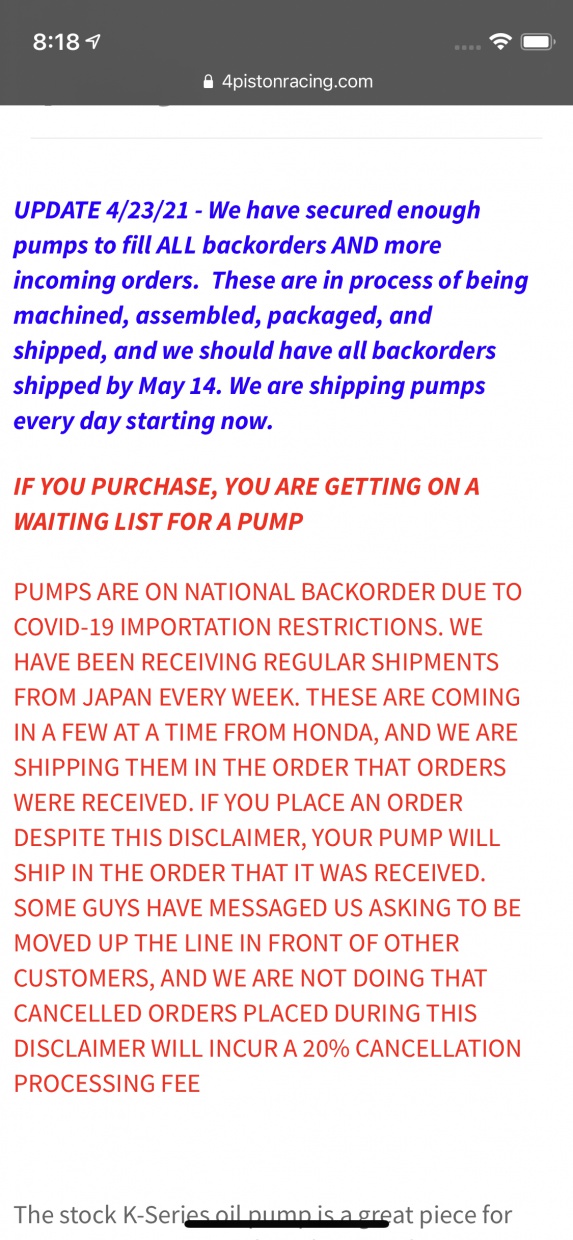

I sent an email to NorthWestJDMMotors and tried to call. No answer so far. I’ll probably get a motor this month or early next month.
RSX Type-S oil pumps are in short supply like many things. KPower is prioritizing selling these to people who bought their swap kits, and I’m 98% sure it is required to use their oil pan. FYI.
4Piston's ported pump won't work?
I’m not sure if their kit will work with the swapped oil pan, but the pump probably will.
Still backordered or in short supply.

That oil pump is good insurance like they said, but I won’t be revving the motor out to 9k.
