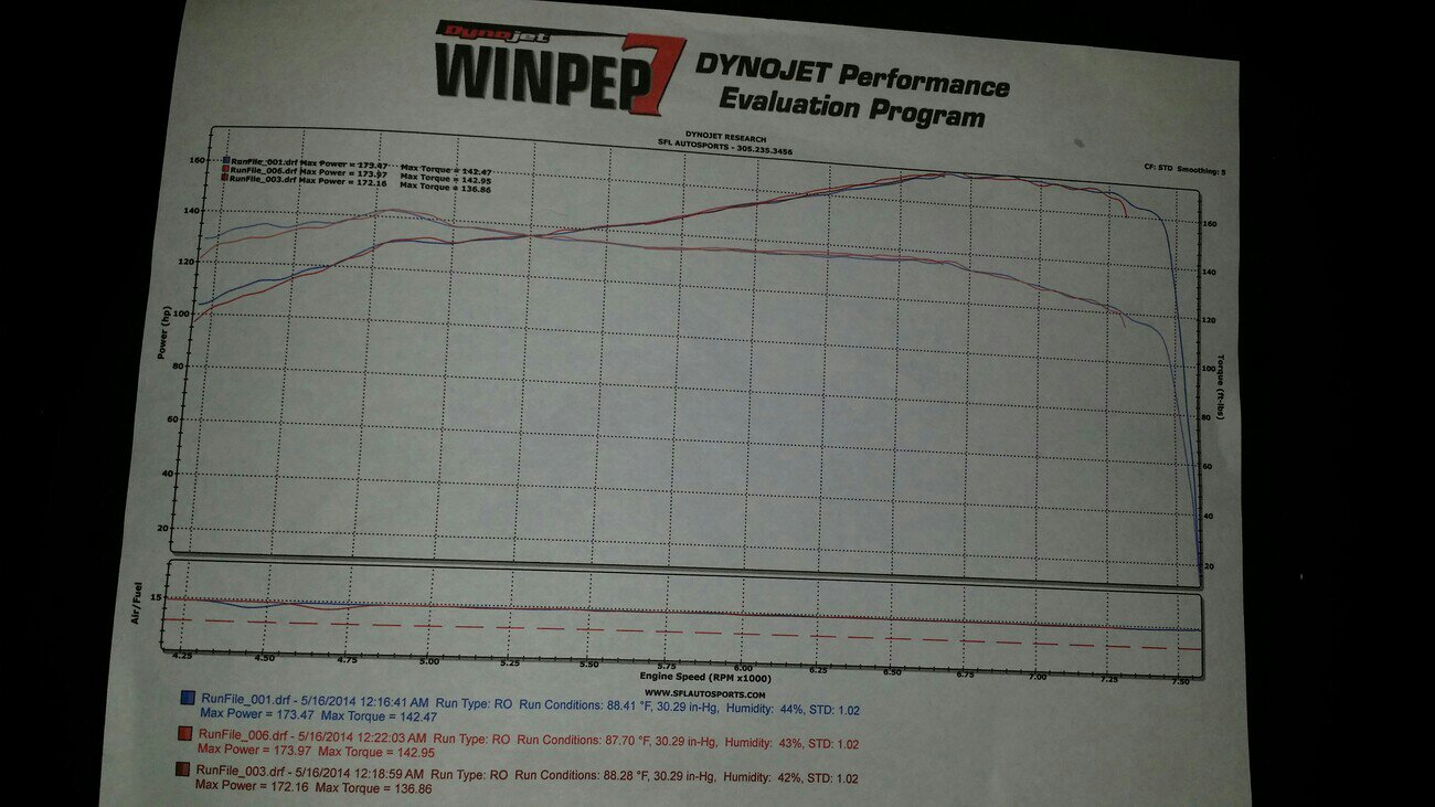

Here is my dyno with 1.58 tune
K&n filter
Stage one tune
93 octane e10
Fwiw another FR-S with "full bolt ons" and no tune made 160 hp same night.

@DC2R thanks for posting that! That's really impressive, especially with the high temp and humidity. I'll be on 91, but those results have me excited to order one soon.
