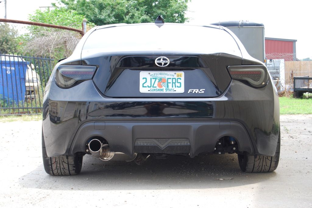

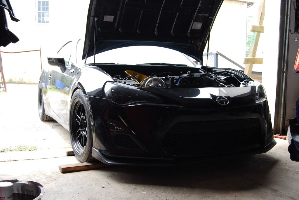

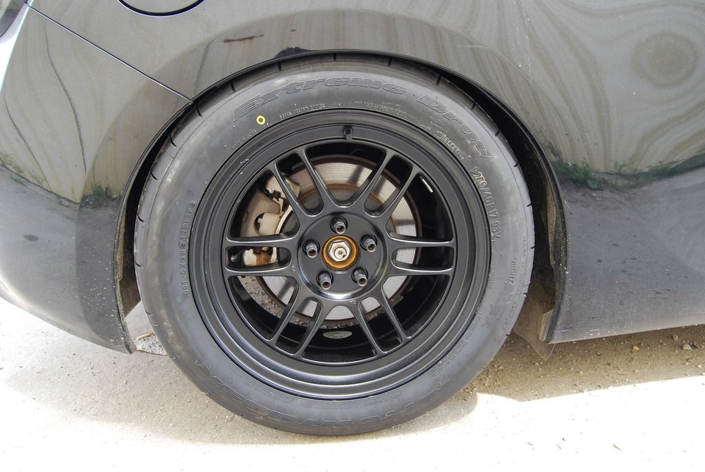

Posts: 960
Thanks: 376
Thanked 623 Times in 315 Posts
Wheels:
Enkei RPF1 - 17x9 +45
Tires:
275/40-17 Nitto 555R rears
245/45-17 Nitto 555 fronts
Suspension:
KW V3 coilovers
RaceSeng CasCam plates
RaceSeng Rear bump stops
SPL rear control arms
-slicktop
2013 Scion FRS
2JZ-GTE/V160 Swap Build Thread

Old 07-02-2015, 10:25 PM   #1395
stevesnj
stevesnj's Avatar
Drives: 2016 FR-S Oceanic Blue
Location: Southern NJ
Posts: 2,958
Thanks: 2,158
Thanked 1,601 Times in 923 Posts
Finally a proper pic for this thread!
My 2016 Build thread
TRD Exhaust with custom quad tips, TRD Lowering Springs,TRD Quick shifter,LED;DRL, Projectors, and turn signals. Re-badge, 86 Nanny, WinmaxW2 Pads, K&N Drop In, Antenna delete

Old 07-02-2015, 10:30 PM   #1396
swarb
Location: Los Angeles
Posts: 3,052
Thanks: 1,773
Mentioned: 79 Post(s)
@slicktop Nice setup. Do you mean 245/45-17 fronts? Where do you rub?

Old 07-03-2015, 01:37 PM   #1398
Jive Turkey
the tuna, no crust.
Jive Turkey's Avatar
Drives: 2014 Hachiroku of the year
Location: jersey
Posts: 2,298
Thanks: 874
Thanked 1,770 Times in 761 Posts
Mentioned: 78 Post(s)
holy fuck those have massive sidewalls!
you probably rub in the rear on the bumper tabs, and will rub in the front where the side marker flares out.
if you roll the rear you'll gain some clearance and can run less camber, looks good though!

Old 07-03-2015, 06:31 PM   #1399
slicktop
Drives: 2013 Raven FRS 2JZ-GTE/V160 swapped
Location: Hampton, VA
Posts: 960
Thanks: 376
No rub yet, but it's a new setup and haven't driven the car much on them. The next few weeks will really tell. And yes, they're 245/45-17 haha
-slicktop
2013 Scion FRS
slicktop is offline   Reply With Quote
Old 07-04-2015, 02:17 PM   #1400
Ruckus
Ruckus's Avatar
Drives: Firestorm FR-S
Location: Oklahoma
Posts: 137
Thanks: 101
Thanked 22 Times in 16 Posts
Those rears though!!! I need 275's in my life. You think 275s on a 17X9 ET35 rears will work?
