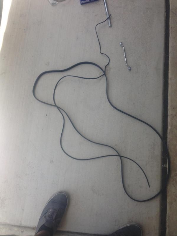

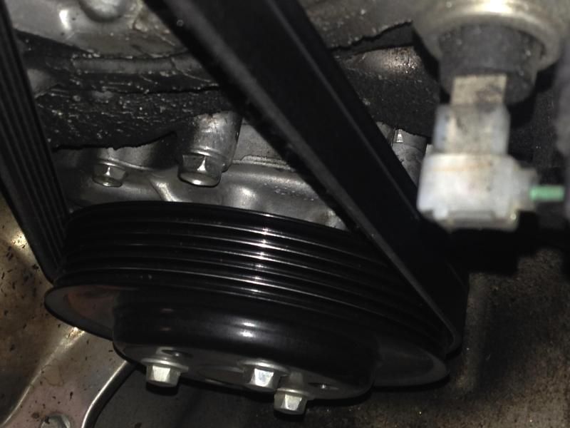

My factory Vortech belt finally broke after 32,000 moderately hard miles on the kit.
It completely peeled off one rib. I looked at all the pulleys and really couldn't determine the mode of failure.
I do know the belt dealigned itself one time with a portion of the belt riding the edge of the AC pulley for an unknown number of miles. I realigned it and drove for about 1,000 miles before I had this failure
My theory of the belt dealignment is that under sudden hard acceleration, the engine rotates which causes the belt to lose tension. It's probably a combined effect with the belt not being aligned straight on the idler pulleys.
