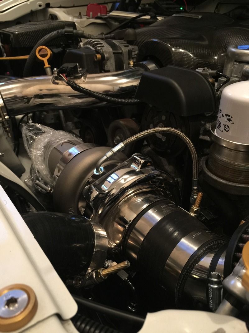

Originally Posted by erok81 View Post
Yep some. Here is my car's current status.
And the important parts. I'm really tempted to the polish the turbo but I reeeeaaally hate doing that.
That'll be UEL I'm assuming? Beautiful looking parts!
This thread is my nightmare. Seeing people get the same parts I'm trying to get, but before me and right on front of my eyes.
That's some beautiful craftsmanship right there. Titanium coated, correct?

Originally Posted by xxscaxx View Post
no, Garrett GTX2867r.
Am I blind? Where's the water line? I see the oil line.

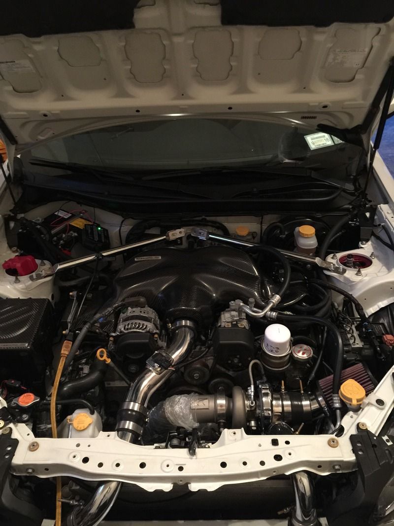

yes
you can't see it in the first picture. Look in the second picture, follow the oil line directly down. You can see the low side coolant fitting.
xxscaxx is offline   Reply With Quote
yes
OOOH! You haven't connected it yet...
Here I am thinking you're done with the install.
