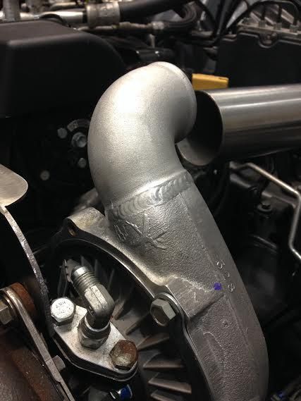

Not going to lie, I was a little nervous with this. Nothing like putting a perfectly good compressor housing through the band saw.

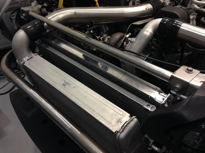

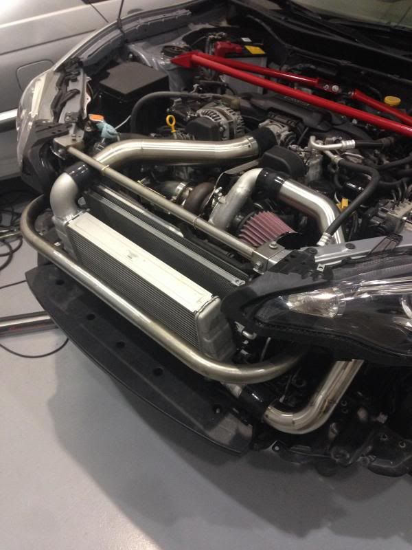

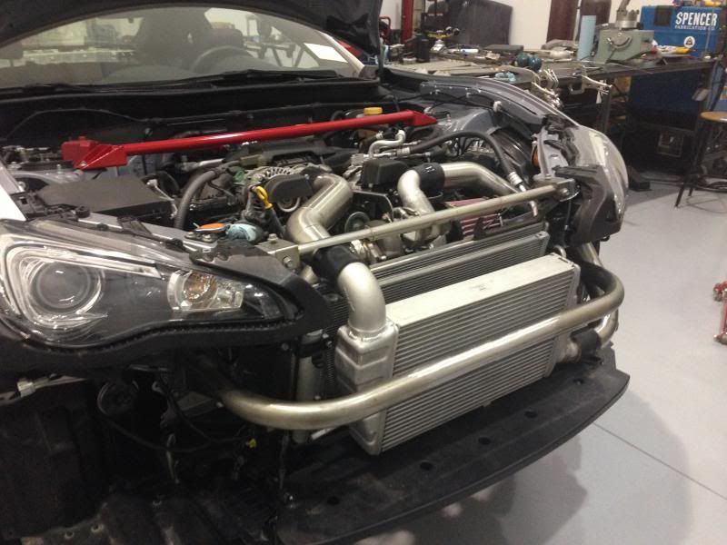

Small update, got the final shape of the IC pipes laid out with the silicon couplers in place. Im going to wait till the Koyo radiator shows up to do the final welding. Turbosmart BOV also on order.

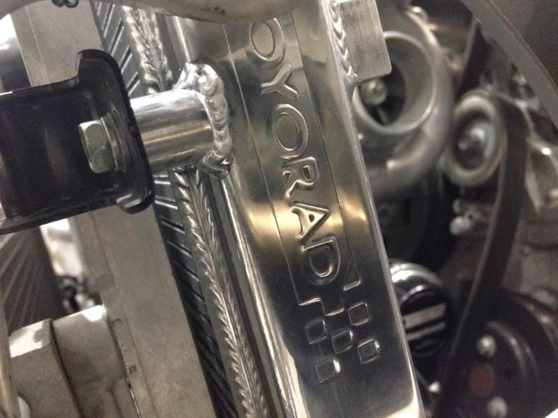

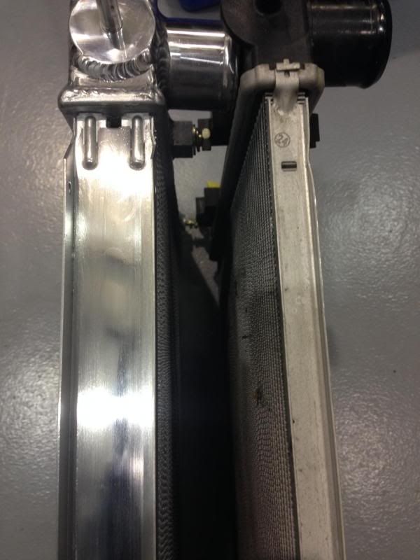

Koyo radiator came in, I am super excited about deciding to go with Koyo. The piece is beautiful and dropped right in not issues at all, wonderful. It even has a port for a temp gauge if I choose to ad one later on.

How much wider across is the Koyo to stock?
As far as I can measure with it now in the car it is not any wider or taller then the stock part, only thicker. 1.43" vs 0.64" at the core.
