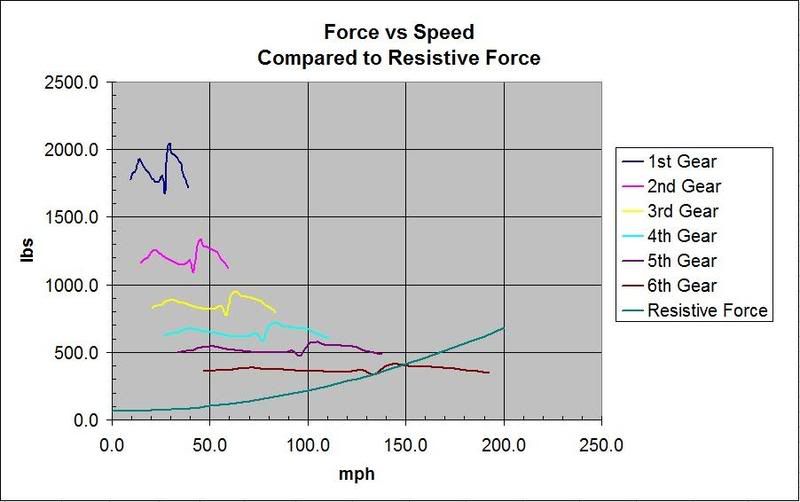

Originally Posted by tranzformer View Post
Power drops off after 7000rpm. Why would you want to increase redline unless you had other supporting mods to make it worthwhile?
Just because power ceases to increase (or even decreases dramatically) at higher rpms does not mean there isn't a mechanical advantage to staying in gear versus moving on to the next gear. I make these graphs when I get a new car. I'll make one for the BRZ when it comes out and we get some baseline dyno numbers. This is one I made when I got my Civic Si: Basically, if you have the baseline dyno, the tire profile/size info, the transmission gear ratios, and the final drive ratio, you can make a graph like that to determine what gear / road speed combination gives you the most force. If you know the coefficient of drag, you can take a pretty good stab at the drag-limited top speed.
