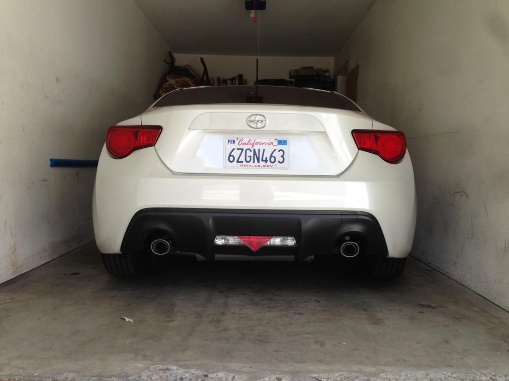

Of course!! I will always take the chance to whore a little

they look niiiiiiiiiice.
were those painted or you replaced the lights?
how much? lol...
since they're red, there shouldn't be any cop trouble for those, right? :happy0180:

Love them. No issues with cops at all.
I used duplicolor metalcast candy red. Then I took them to have cleared at the body shop. Just tell them not to sand the lights after you've painted them red. I had to redo mine because they burned through the red the first time sanding them!
If you have a body shop that is ready and willing to go, you can have them done in a day.

No problem! It really is easy and fairly cheap. If you can't get them cleared for $100 or less, go to someone else :happy0180:
