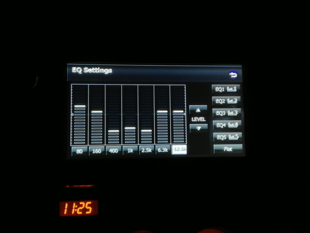

Personally, the system is severely lacking in basic 'loudness'. Needed a mere boost to bass and treble. These settings worked for me across a range of styles - R&B, dance, rock, etc.
I kept the position to zero.
Hope these settings work for you

You are correct in that this radio does not have Loudness. This is a VERY good thing, as Loudness sucks. Loudness is a non-linear EQ setting that boosts bass and treble at low volume. That being said, the Bass is already over boosted as is prior to any EQ settings, and the lower midrange cut there is a bit harsh.

Agreed the "loudness" setting on most stereo systems is terrible. For anyone wondering, by "non-linear" it simply means that the EQ effect is applied differently at different volume levels. This may sound like a cool idea, but in practice it only screws up the overall EQ, often making the music sound tinny and muddy/boomy at the same time. Personally I think it should go the way of the dinosaur. The BRZ's 7-band EQ is light years better than what a generic loudness setting could offer.
