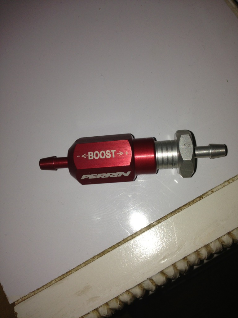

Originally Posted by whitefrs View Post
One last question
Attachment 37585Here is a pic of the MBC.
Does it matter what way the ports go?
Like + sign nipple goes to wastegate and - sign goes to vacuumm manifold?
Per the instructions, - sign to vacuum/boost signal, + sign to WG. If you do it inversely, your WG will not open, happy Overboosting!!

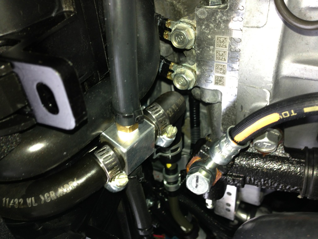

I have a vacuum manifold, so I cut the line near my manifold:
Basically a line comes from the vacuum manifold into the MBC, and then goes down to the side port on the wastegate.

Originally Posted by SmsAlSuwaidi View Post
may i ask what is the fastturbo with lines ?
That is the vacuum manifold. It pulls vacuum/boost from the back of the intake manifold where the PCV line normally attaches and then the manifold splits that good reference to my boost gauge, BOV, EBC, EBC solenoid, and wastegate. I am using all 5 ports now.
Thats what i thought but i always love a second opinion
Thanks bud and again i really appreciate ur help

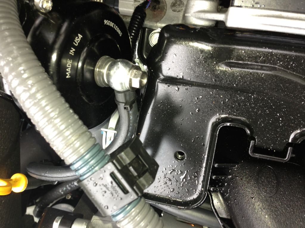

Ok guys one more question and hopefully @King Tut can chime in
(Now with pics)
I know i have to cut the hose that goes from vacuum block to wastegate port but this house has a T that also goes to the BOV.
Do i still cut the hose and add it there?Name:  ImageUploadedByTapatalk1368985568.733595.jpg
Size:  156.2 KBName:  ImageUploadedByTapatalk1368985579.732420.jpg
Size:  106.8 KBName:  ImageUploadedByTapatalk1368985592.099845.jpg
Size:  172.7 KBName:  ImageUploadedByTapatalk1368985617.849495.jpg
Here is a pic
1) wastegate port
2) T connector
3) hose to vacuum block
4) hose to BOV
(Now with pics)
Sorry for the late reply. You need to install it AFTER the Tee in that line that goes to the WG. Feel free to get some couplers and extend those lines up to where it is comfortable for you to manipulate it.
