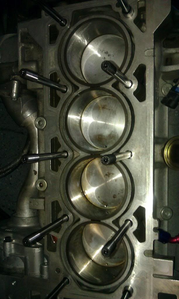

LOL@ Steam cleaning the internals.
I thought that was a joke at first too, even googled it to find quite a few other WMI sources claiming the same thing (valves, valve seats and piston tops anyway)

haha thats awesome I really would like to see the results of it after a few k miles haha

Ok so I know I said I would post this later this evening but I happen to have a pic on my phone of one of my 400whp engines that has been running 20+psi from a Mitsubishi super 20G hybrid and water/methanol for the past 70k+ miles. I built this engine in 2007 and what you are looking at are forged flat top Wiseco pistons with a CR of 10:1. This is what it looked like about a year ago (5 years later) after pulling the head to replace a head gasket that had literally the tiniest coolant leak ever in cylinder #4 (hence the reason it is slightly cleaner than the other 3 piston surfaces). They look damn near new still. I just happen to notice a tiny droplet of water sitting on the cylinder wall while doing a visual inspection via scope. Any little problems drive me nuts because I am a perfectionist so off the head came. I snapped this picture because every time I see how clean everything is from a WMI system it always makes me smile.
