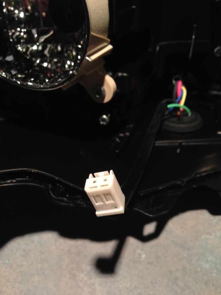

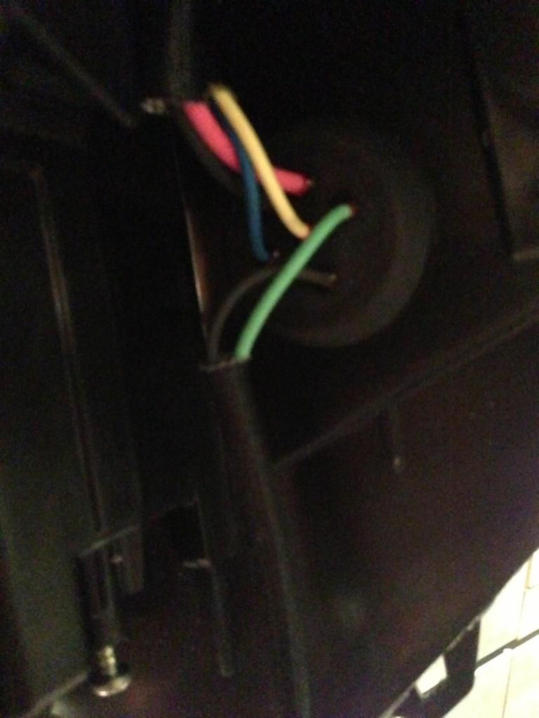

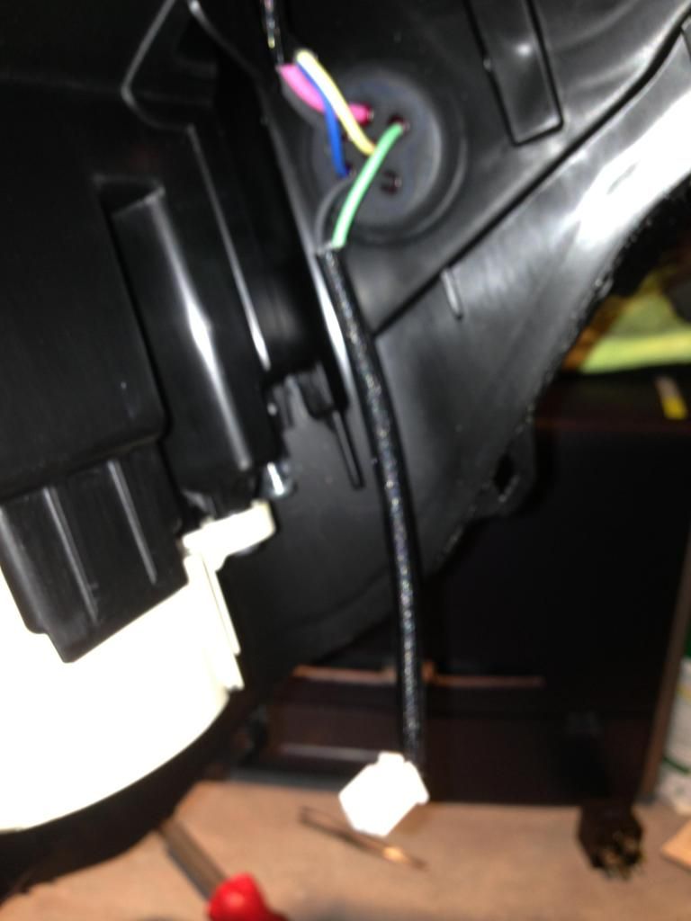

You are looking for the black and green wires coming out of the back of your headlight the green is the positive for your led and the black is the negative.
